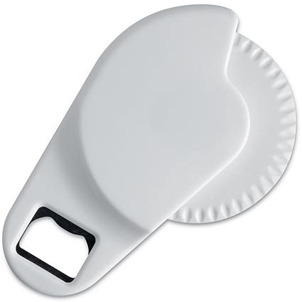

Essex2Visuvesi
You mind one of these helpful
Plastic Pizza cutter, less chance of damaging the plastic

Pizza cutter tip - I like it.  I've got quite a few plastic trim tools as well so they should come in handy.  The pizza cutter will have a firmer/harder blade for leverage though I suspect.

[edit] Oh yeah, and I need to buy a new pizza cutter too.  s:oops: :oops: s:oops:   s:lol: :lol: s:lol:
