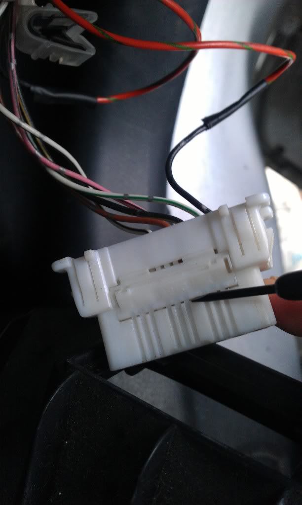

so, you plug it in and the ABS goes bananas! After a bit of digging, I found out that the reader (maybe not others) scans all the pins looking for the ecu.
 Problem is on turning on the ignition the ABS ecu wants to talk to something and throws its toys out of the pan when it sees something it cant talk too.
I tried the flicking the ignition on and off trick others have been doing but wouldn't work for me.
so, not wanting to unplug it all the time i decided to remove the pins the OBD2 reader doesn't need.
Below image is the 2 pins that are needed to be taken out. Also a good use for the passenger window on/off switch (OMG how pointless)
 is to loop the +12 feed to the port through it. have a nice little reader on/off switch then   s:) :) s:)
remove the pins by using a little screwdriver to open the side flap then you can pull the wires out buy holding back the little plastic clips on the inside of the port connector.
put tape round the ends so they wont earth out, Job done!
This has the bonus of if you need toyota to look at your ABS at some point, you can just put the pins back in within 10 mins.

maybe the versions before 1.4 don't try to scan these pins for an ecu. From what ive read on other car sites (non mr2), the pins are normally plugged into ecu can bus for but with toyota, they used them to comm with the ABS ecu instead hence ABS wobbler.
here is a pic of the pins on the reader:
I will double check the earths but i'm sure that's correct.

yeah, is the abs ones. might be an idea to pull the wires from the plug fist to double check. Or wait till sat so i can take the plug off mine to confirm. wouldn't want you to bust a good reader  s;) ;) s;)

 s:D :D s:D  Pulled these two wires today and no more flashing ABS light and no need to flick the key on and off three times before I can start the engine, all is well so well worth the few minutes it took to do, so thanks Mr X

Actually I had a look inside the obd2 blue tooth reader,   you need to remove 1 'abs' pin which is #14 in obd2 pinout in OBD2 reader by opening it up and remove the pin '#14' in connector connecting to board.  don't forgot to tape it up or cut it off.   other ABS pin #9 is not connected in this obd2 blue tooth reader.
