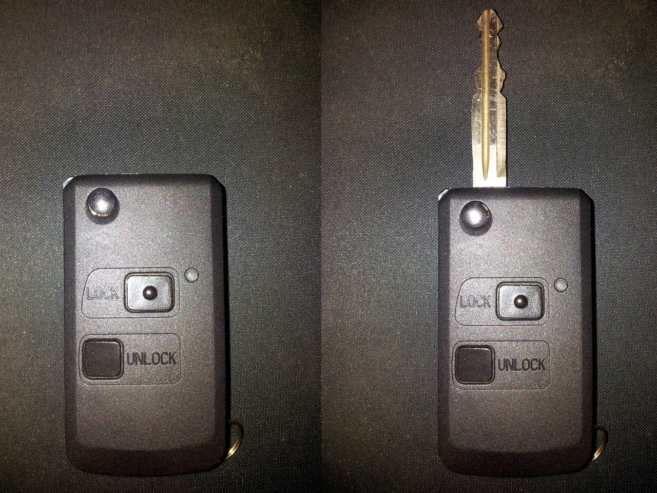

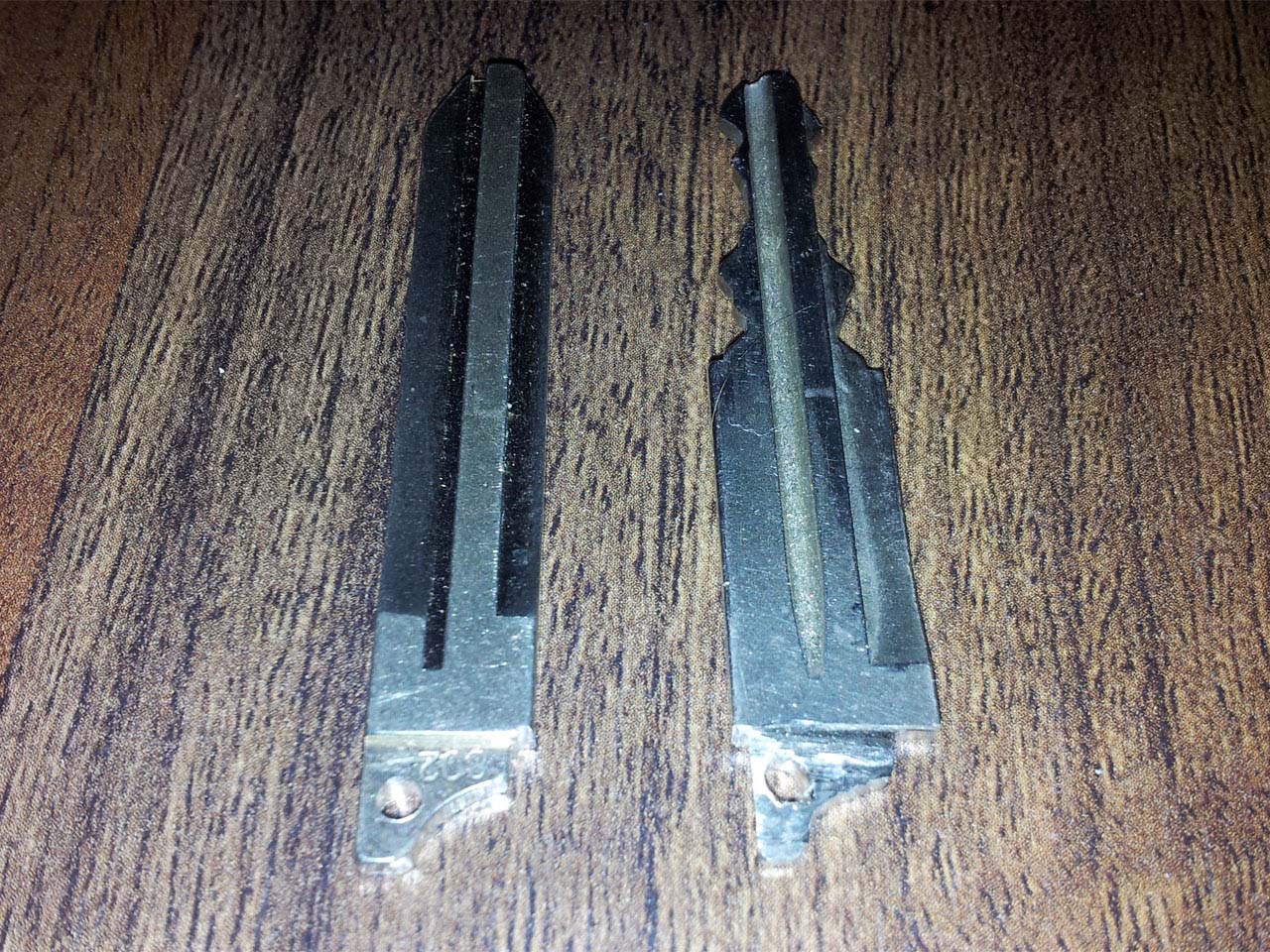

#43
Here's a couple of photos of one of the 'other' styles that I used:
Cut down to size with Dremel.

#44
Here mine. Took me about the same time (1hr 30ish) with my dremel. Quite easy to do and looks great  :-) :-) :-)
