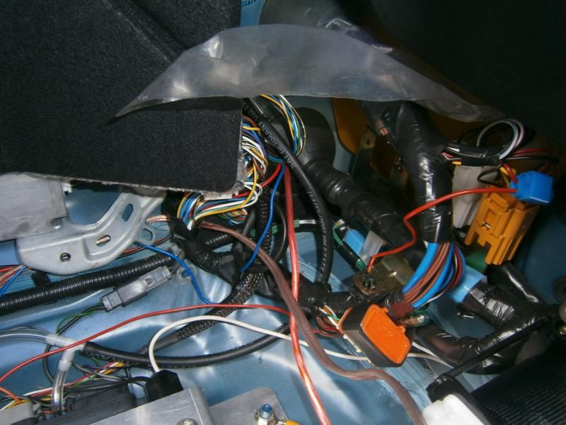

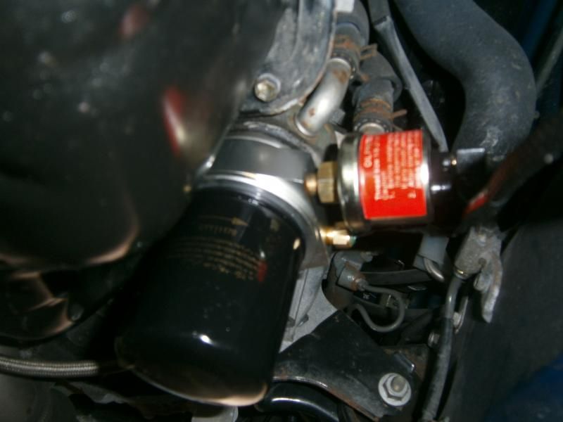

Well did my first DIY oil change in years today and fitted the oil pressure and temp sensors.
First job prepare the sensors and plate.  I used heat proof braid (off ebay) to protect the wiring in the engine bay.
Then jack up the driver side, remove the under tray off the car, and carry out the normal steps for doing an oil change.  ie drain out oil from sump and remove oil filter.  The sensor plate screws onto where the oil filter goes, then the new filter screws onto the sensor plate.
I ran the wiring along the underside of the car to the passenger side then up the engine bay and into the passenger side bin gromet.  3 Wires (next to the large red wire off my amp in the pic).  Ground (blue) and sensor (red) for the temp, and just the one wire (black) for the oil pressure sensor.
Heres the boost sensor tapped off the TTE MAP sensor and ECU, I did a few weeks back.
The 3 sensor wires run across the driver side bin and along the driver side sill to the gauges.
The sensors work well but I have one problem to solve.  I have an oil leak which looks like its comming off the oil temp sensor.  I need to get a 10mm spanner to tighten it up see if it cures it.  I have an adjustable spanner but I can't get enough torque on it without it slipping.  Can you buy any sort of heat proof thread seal for problems like this?

stargazer30
#28
Quote from: "mrzwei"I've used Granville 'blue' gasket sealant on a number of occasions, resistant to all fuels, withstands high temps. and suitable for metal to metal joints'
 m http://www.granvilleoil.com/product_info.php?prod_id=51 m
I'm sure there are other products out there.
Do I have to slacken the sensor to use this and put it on the thread?  Its as tight as **** to the point where I rounded it off a bit.  Still weaping when the engine runs   s:cry: :cry: s:cry:  Or can I put it round the exposed thread at the joint and still stop it.

mrzwei
#29
Ideally you would have to slacken the thread, I don't think it will work as a filler on the outside.
It is designed for use during assembly really as surfaces should be dry.

stargazer30
#30
Quote from: "mrzwei"Ideally you would have to slacken the thread, I don't think it will work as a filler on the outside.
I tried it on the edge and your right its not working.  DAMN!!!!  So now I have to drain off brand new oil just to take the plate off so I can seal it.   s:( :( s:(    s:( :( s:(    s:( :( s:(    s:( :( s:(

stargazer30
Been reading up and apparently you're supposed to use PTFE tape on the threads (like plumbing)  Whoops!  So things that have me worried now;
Once the plate comes off will the rubber seal still work as its been compressed once, do I need a new plate?
Should I used PTFE tape or use the gasket sealer?

mr-ed_smt
#32
You can reuse the oil - just make sure you drain it into something clean. Shouldn't be too difficult to drain it off and refit the sensor?

stargazer30
#33
Right, what a pita that job was.  Oil drained off, filter off, plate off and sensors out.  Cleaned it all down and used liquid gasket on the threads.  Put it all back together again, refilled it with oil and no more leak on the plate or sensors  s:bounce: :bounce: s:bounce:
So big watchout for any one doing this job, put liquid gasket on the sensor and bung threads!

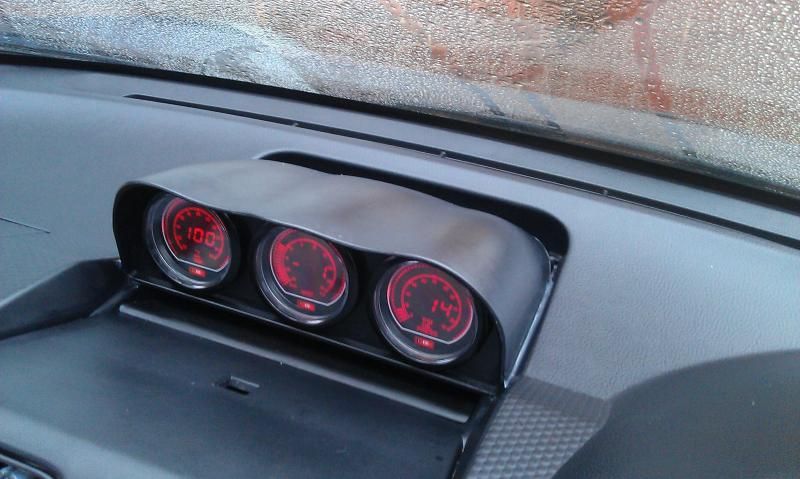

stargazer30
Right its took a month to get it from overseas but the new dash pod arrived this week from eBay.  Much better looking than the UK carbon fibre ones I got first off and almost a direct fit to replace the centre lid once I dremelled off the lip around the edge.   This is still a work in progress as I need some trim to cover the front and some black foam or the like maybe at the back.
Excuse the crappy phone pics, I'll do better ones once its done properly   s:mrgreen: :mrgreen: s:mrgreen:

nathanMR2
#35
Looks good mate  s:) :) s:)
