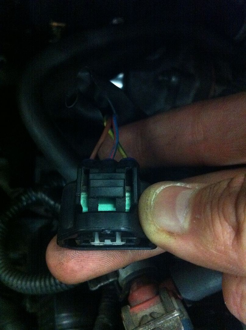

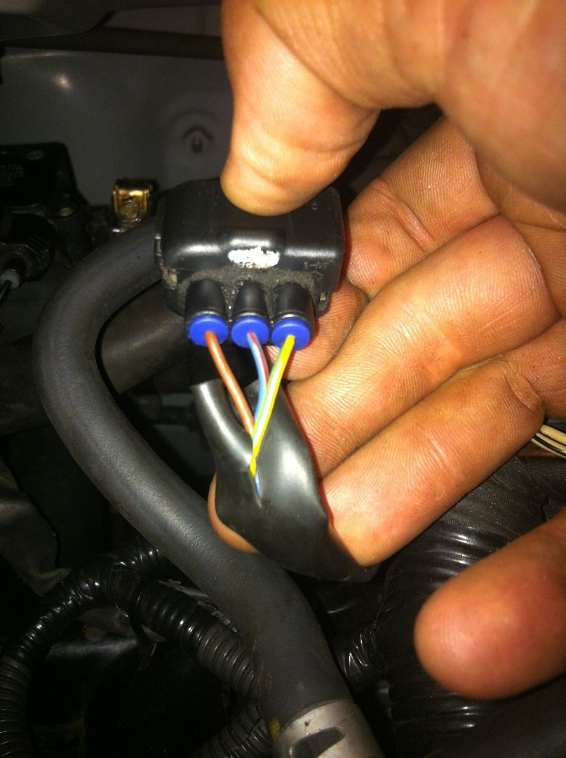

thanks guys for your replies, really apreciate your help. Turns out it is something related to tps - I listened to advice saying disconnect one sensor at a time and see what happens. Guess what - disconnected tps and the engine runs perfectly! It is very strong a rev happy, and sounds like a bike too!  s:) :) s:)
But what is strange, I suspected the tps in the first place and checked everything - the sensor, the wiring loom and it was all ok. I swapped tps wires correctly too, I uploaded pictures to forum and members confirmed it is ok. The only solution I see here is maybe they were wrong, and I swapped wrong wires? Can somebody post a picture how exactly tps wires should be on 2zz?

Back to my engnie troubles and how I solved it - turned out I didnt ever had to swap tps wires, this is how my tps is wired now and the car runs perfect! I doon't know why, I chased all wiring loom from ecu to tps, checked the wires, It was all connected how it should be (ecu pins e2, va vta) but it didnt want to drive, but now it is a monster
