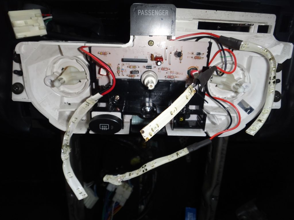

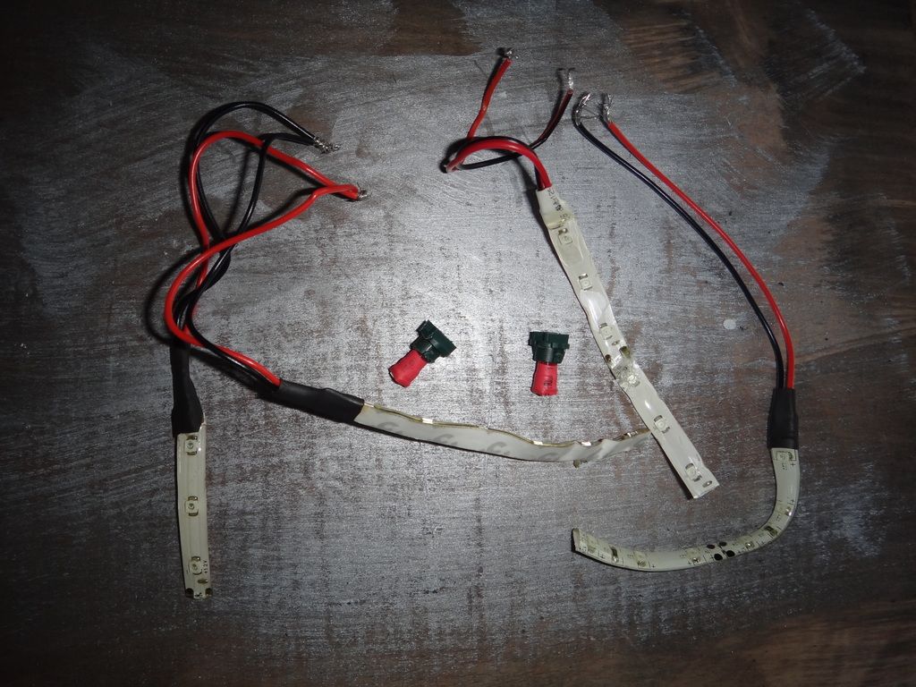

Got a wee surprise when checking my heater bulbs   s:scared: :scared: s:scared:
Having sorted my main dials I recognised the LED wedges but not the ribbon beasties and the behind the scenes "connections":
So a tad of weight loss:
The two green holders are the bulb holders with the bulbs replaced by red LED wedges.

Correct Nunfa a misuse of LED's combined with bodged wiring.  For anyone thinking of doing this just look at the strips, all damaged melted and brittle.  Also loose wiring at back of PCB could have shorted the lot   s:flame: :flame: s:flame:

Hi Standard looks like the driver's side bulb has failed.  See first pic of mine above the bulbs were replaced with LED wedges.
Pull off the 3 dials and the knob on the air-vent slider.
Remove the two screws and you can pull out the facia and see the bulbs or possibly some mod (LED?).
To get at the bulb holders its 3 small screws and pull forward the PCB.  Watch out for the "passenger" plate or it will disappear somewhere   s:( :( s:(
