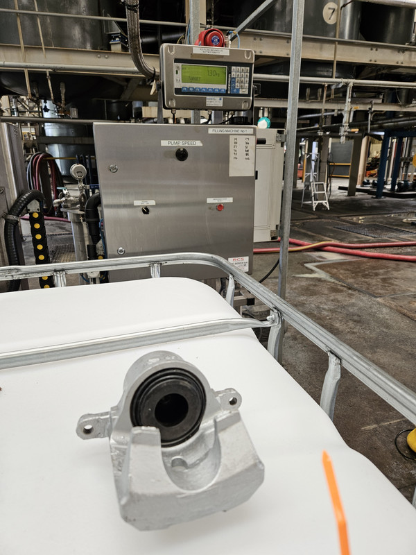

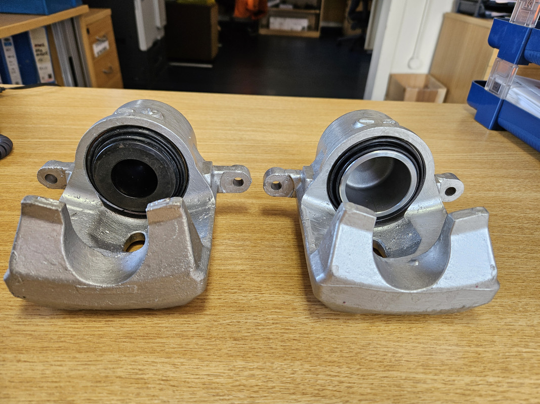

Calipers arrived but there's a problem. One has been rebuilt with a Phenolic piston, the other steel.
Not sure which to replace?
The steel one looks like it could be to big to press on the whole of the brake pad.
On the other hand will the plastic piston be up to the rigour of heavy track work.
Edit: looks like the phenolic pistons are discontinued anyway.

The discontinuation answers why the the other is steel.
Does not answer your question about whether it is up to track use. Basically underlines that question with ´why discontiuned´ . Can be simply cost of manufacture but for the moment it´s a question.
Is it phenolitic ´plastic´ though. In the specs they are mentioned as ceramic.
As to the shape of the steel one, are the steel backings of the pads not stiff enough?

Quote from: Petrus on June 29, 2023, 11:00The discontinuation answers why the the other is steel.
Does not answer your question about whether it is up to track use. Basically underlines that question.
Back to the weight: Like it?
Crazy light yeah.
I'll go with what I know in steel. I'll dry test fit first with the MR2 brackets to make sure there's no overhang of the steel piston to the pads, hopefully wont be an issue but the difference between to 2 piston contact patch widths is 7mm. Plastic contact patch is 47mm, steel 54mm. Even if there is a slight overhang I dont think it'll make much of a difference.
From memory of the inner pad imprint on the MR2 51mm piston there is plenty of room for the extra 3mm diameter of the 54mm Prius piston.

Steel pistons are 200g heavier then the OE Phenolic pistons.
1.3kg v 1.5kg
