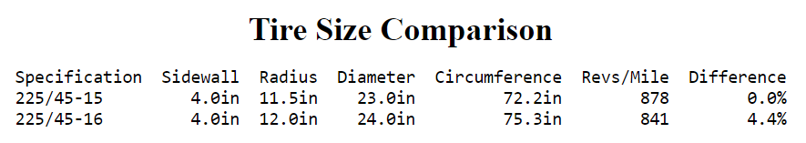

I'm now looking to replace the rear 15" wheels with 16"s. Currently running 225/45/15 AR1's or very similar sized slicks and this gives me a 4th gear top speed of 104mph. At Oulton my top speed was just 108mph in 5th gear, so all I need is an extra 4mph in 4th.
If my calculations are correct I would need to change from a 225/45/15 to just a 225/45/16, this would give a 4.4% increase in Revs/Mile which should equate to 108mph in 4th gear, does this sound correct?
Dont think this change will have much of an effect on the final drive ratio and ultimately performance given the OE FL size rear was 215/45/16, which is just a 1.5% increase on Revs/Mile using a 225/45/16.

I haven't checked your math however the profile of the tire is tied to the percentage of the width so the wider tire with the same profile being 45 would be taller and therefore have a different percentage for revs per mile. How much more I do not know but the calculator would tell you.

Quote from: JB21 on October 14, 2021, 12:58Dont think this change will have much of an effect on the final drive ratio and ultimately performance given the OE FL size rear was 215/45/16, which is just a 1.5% increase on Revs/Mile using a 225/45/16.
Thoughts?
 I was commenting on this part.  If we know the difference between the PFL tire size vs FL percentage then I assume there is a difference there that might add up.

2.4% differnece PFL to FL, 874 v 892 REV/MILE
Dev
Better yet the difference between  225/45/15 vs 215/45/16 and see what you get.
JB21
Dev
Quote from: JB21 on October 14, 2021, 14:01
Quote from: Dev on October 14, 2021, 14:00Better yet the difference between  225/45/15 vs 215/45/16 and see what you get.
2.8%
 Im getting 4.3 if we add the difference between the 2 16" sizes which is 1.5.
Close enough.
