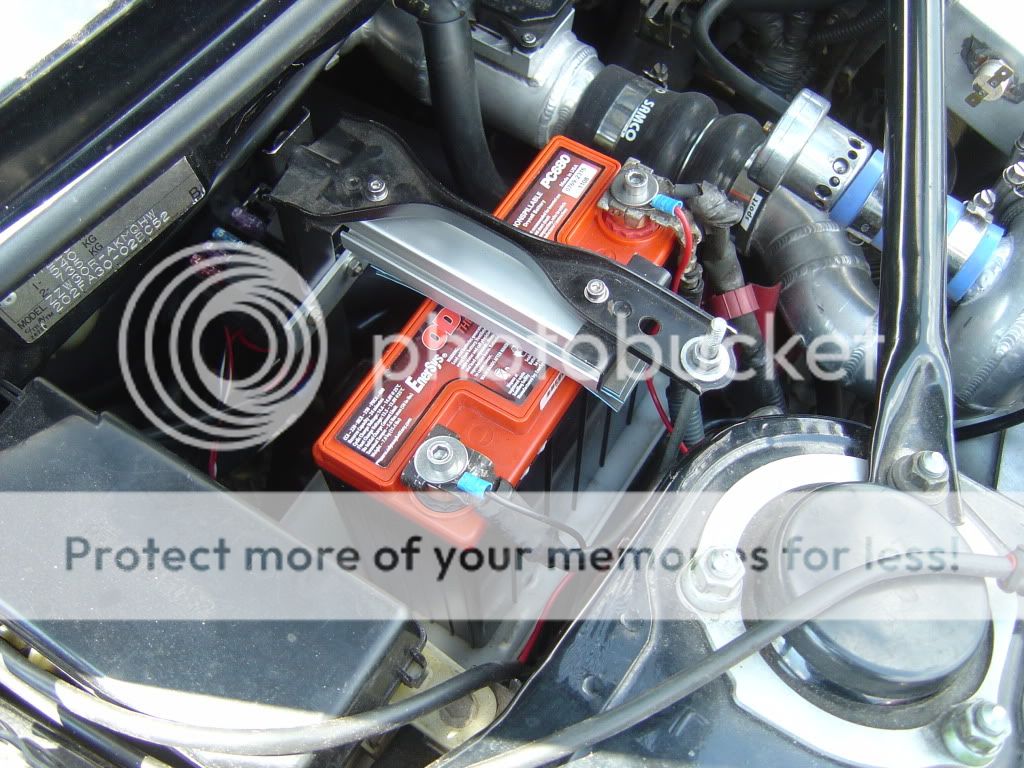

Well I've had an awful day for many reasons, The ones involving my two started with it not starting. Didn't start after work and again this morning. AAAARg. Very upset with it. Managed to get the Odessy in enough to run and it started on that. Bit of finish bodging at work and I'm left with:-
I've charged the other battery and it seams ok but I think I'll just run the Odessy till it's off the road at the weekend when I'll hopefully get the battery tray made.
So as well as that I've got a E 8 fault code on the Innovate.   s:evil: :evil: s:evil:  , Dam thing, So manual says it's either knackered or over temp. It does start up and run for a while then the code comes up. Find it hard to believe it's over temp. I know I've now wrapped the exhaust which will keep the temp in a bit I've not bee pushing itand the code comes on every time I drive it now, I can only presume the sensor is knackered.   s:( :( s:(
