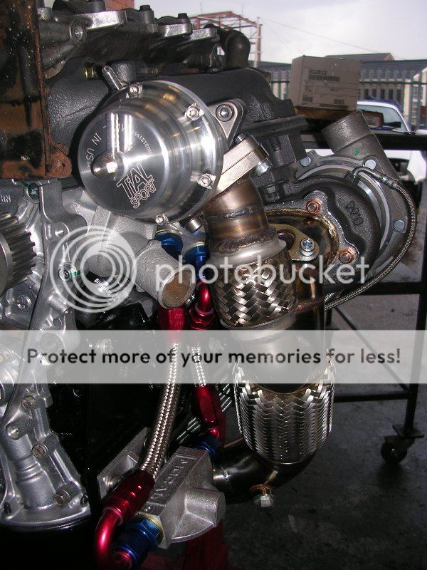

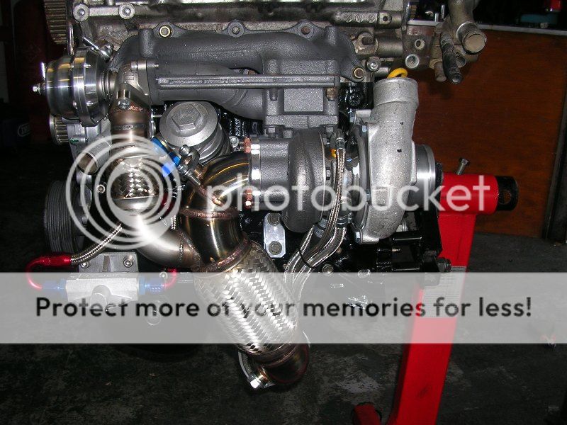

Popped down to Tim's yesterday to pick up the build. Have to say, really impressed with how it looks. Would definately recomend him.
I couldnt resist seeing if it will all fit so threw the turbo kit onto a dummy block that I had mounted ready (dont want to be fitting and removing the real engine till the install is all done)
The external wastegate is a custom install to make sure it clears the overhang in the roadsters engine bay, as you can see, loads of room.
I was expecting to have to rework the chassis crossmember to clear the downpipe but I actually have slightly more room than the old setup so really pleased with that. (still close though so plan to make a little heatshield)
Also, the new turbo (GTX2867r) is slightly smaller that the old ct26 so I have a little more room to the firewall, which is useful as I want to improve on the heatshield I had previosly made.
