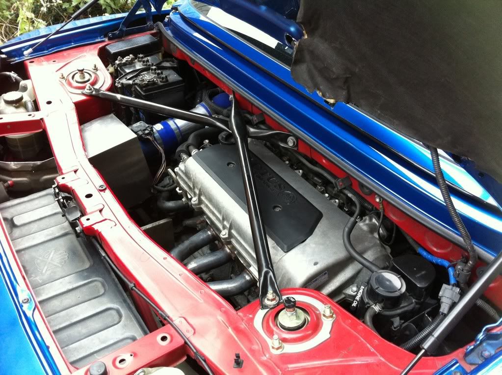

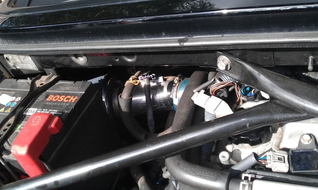

Ilogik
When I had the thermostat done I had all the coolant replaced a the system Bled.
As for getting hot glad I am not the only one who thinks it get super hot under the boot lid. Looking at the celica;s and corolla,s they all have vented hoods/scoops possibly for this exact reason. The mr2 slots arent very good, especially with the rain tray in place, i had considered fitting some engine bay fans and getting the manifold thermo wrapped, but reading up on having manifold wrapped seemed like it could cause other issues like trapping water and heat.
What intake are you using? and what size intake tube?

I'd have to look at my paperwork to see the details (came as part of the Rogue conversion) but this is what it looks like :

Ilogik
Is that a little rocket manifold? mines quite different.

dcod
I will have to findout the make.
I see you have the 2zz out of a Lotus! Did it cost a bit? Where is your rev limiter, 8500? Mine is 8200 (Celica GTS).

Ilogik
Its from a corolla, but I think my ecu is either from a celica or a corolla, i lost track as we swapped them around a few times. You can pick up the cover from lotus for about £16, good for keeping your spark plugs dry.
