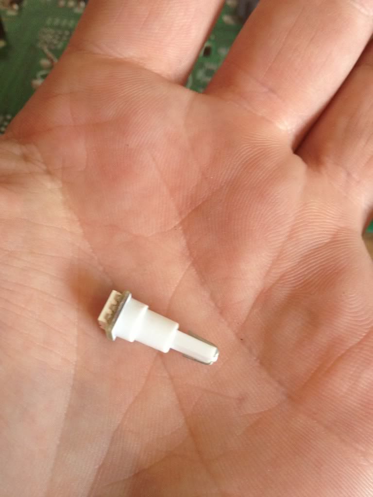

Just so you know if your putting in LED's you need to make sure the flat bit on the side of the LED is on the negative side of the board or it wont light up! ill try and stick up a pic of mine

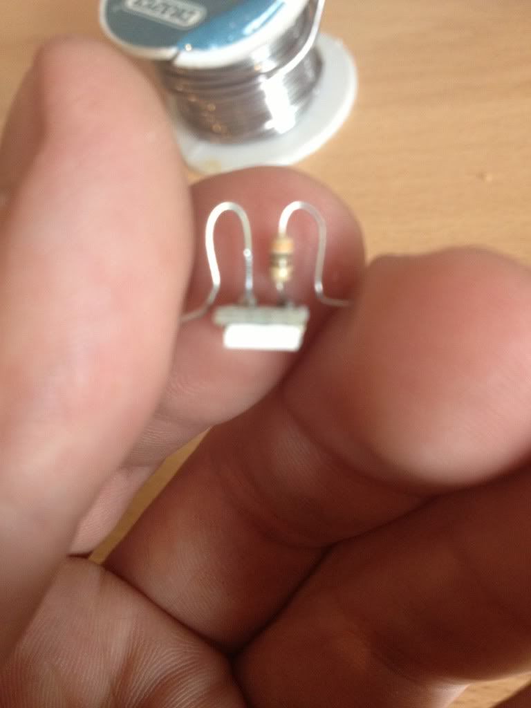

Ok so here you go!
First grab some LED's off fleebay or any other source you chose!
when you get them you need to check they all work by putting the ends on a 9v battery now sometimes there will be a resistor on the negative side of the LED or a flat mark on the LED now is the perfect time to take note what end is negative / possitive.
Ok so now we know that they all work rather then fitting them in then finding all the hard work was a waste of time!  s:x :x s:x
now what i did was replace all the bulbs with led's so go ahead and remove the bulbs that you want to change ( i kept the indicators and high beam light the same ) now go ahead and pull the led out of the holders and bend the ends over like so.
now hopefully you would have removed the old bulb and holder from the main board all you need next is a solder iron and some solder with flux, run some solder over the connector where the bulb was now this is the tricky part!
you need to work around the board but be very careful!! This is a Double PCB and one scratch to the board will damage it !!
And solder all the LED on to the board.
Now the 3 bulbs you see on my board are for the indicators and high beam lights i kept them the same as above
TaDa! now that's done pop out to the car and connect the 3 main looms to the dash and turn you lights on they should work! BUT if they don't you need to take note what one light up! take to board out get a the 9v battery on the led that worked and work around the board spinning the led's around so negative comes positive once done get the 9v battery on a led to see if they all work! Bit of a pain but works a treat!
