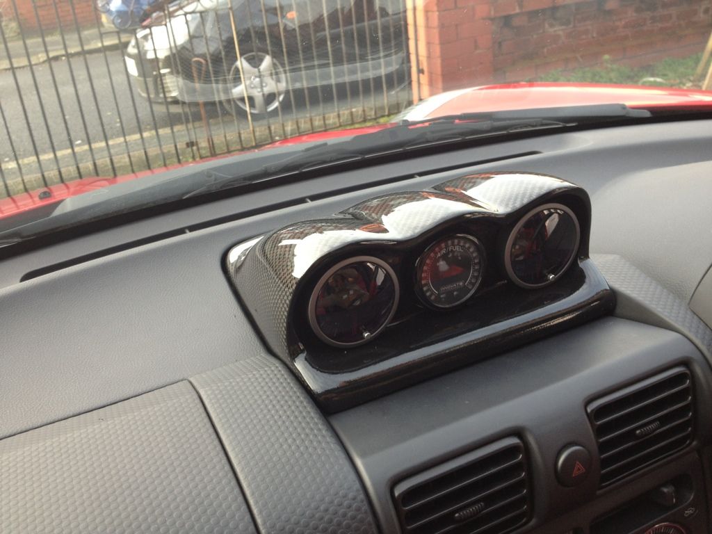

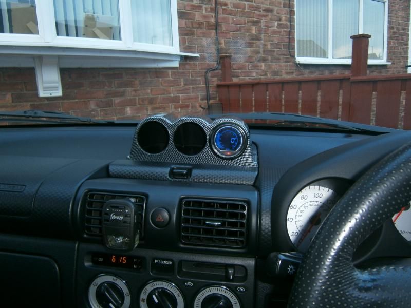

** Thread Update **
I have the 3 gauge pod fitted now, with my boost gauge wired in.  The pod doesn't exactly look OEM but its not too bad until I can get something better.

mr-ed_smt
Got any pictures of the final install Stargazer? I've got 3 gauges and an almost identical pod (albeit just in back not carbon effect) to fit this week hopefully.
[size=85]The never ending project - cherished daily driver, to fully-caged track toy![/size]
stargazer30
Quote from: "mr-ed_smt"Got any pictures of the final install Stargazer? I've got 3 gauges and an almost identical pod (albeit just in back not carbon effect) to fit this week hopefully.
Where did you get the black pod from?  I wanted black but could only find stock of the carbon effect ones. It does kinda go with the dotty trim on the MR2?!
Not final pics but work in progress   s:D :D s:D

Thanks - looks good, exactly how I'd imagined. Loads of black triple gauge pods on eBay! How did you run the wires and tubes - through the bulkhead and under the carpet or under the car and then up under the dash?
stargazer30
Quote from: "mr-ed_smt"Thanks - looks good, exactly how I'd imagined. Loads of black triple gauge pods on eBay! How did you run the wires and tubes - through the bulkhead and under the carpet or under the car and then up under the dash?
No tubes, I used an electronic boost gauge.  It has its own MAP sensor which is plumbed in at the same point as the toyota MAP my TTE turbo uses.  So whatever toyota's ECU sees my gauge sees the same.
So its a straight run of 3 wires from the rear passenger side bin (thats where the wiring comes in from the engine bay), across the back, down the drivers side, under the steering column and then up under the dash where the pod is.  Thats an easy route as the trims just clip off and the existing stock wiring provides an anchor to zip tie the new wiring to.  Only took an hour and a half to do it.

spit
On the pod, I think it looks better if you cut the skirt off it and shape what's left to bond it to the lid. It stands a bit tall otherwise. IMHO.

mr-ed_smt
Looks goods - are those 52 or 60mm gauges?
spit
60s in a 52 fleabay triple pod

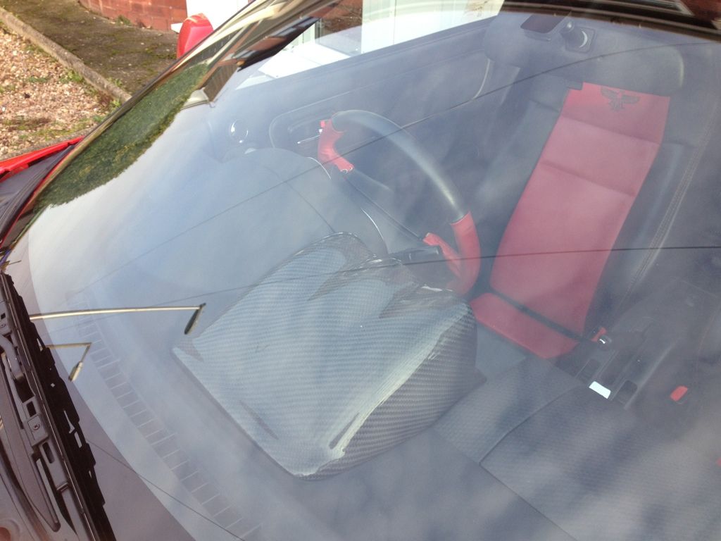

I found this one on the bay
http://www.ebay.co.uk/itm/UNIVERSAL-TRIPLE-60mm-3-GAUGE-CENTER-METER-DASH-PILLAR-POD-/321005476663?pt=UK_CarsParts_Vehicles_CarParts_SM&hash=item4abd6adb37
But its slightly too wide. I am thinking to taking a gamble seeing if I can cut it down and bond it to the lid.
