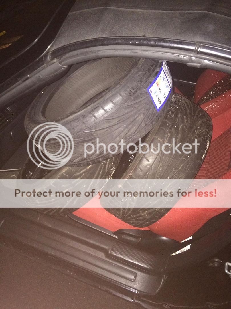

Learnt some thing new, you can fit 4 wheels in an mr2!!
Nice! What you got?
Oh sorry... The team dynamics I guess  s:) :) s:)
Sadlebag
One in the boot....
And 3 on the passenger seat  s:) :) s:) .
