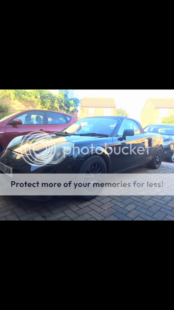

Yeah i really need to update this so here it goes... well first off the under tray is not on, i think that is going to be put on over the winter as i want to make it so its easy to bolt on and bolt off.
Progress has been made though supercharger side. i have a CAD design for the alternator bracket but the guy who made it wont give it to me, he wants to find a machinist for me he just doesn't want to hurry about it  s:( :( s:( . I do have another guy also trying to make one, once hes back from holiday.

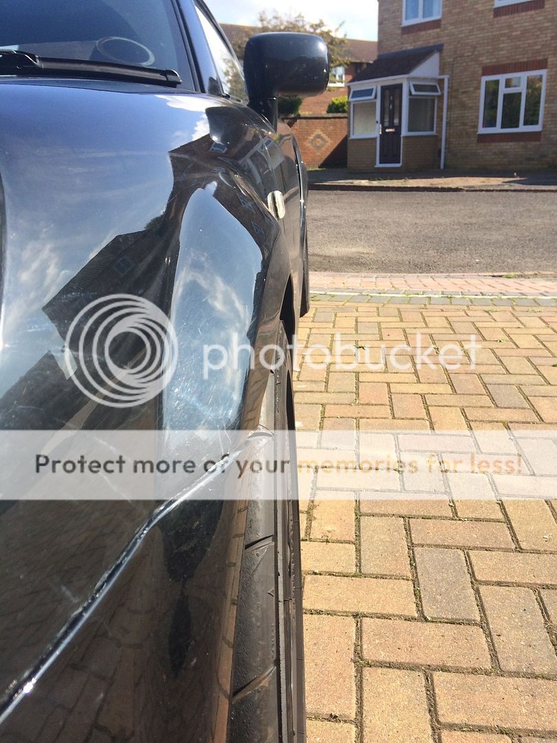

I have though got some things done, the car failed its MOT on rear suspension bushes so figured out id take the plunge and go for new arms all round with polybushes, so they are now in at the back. I also finally got my parcel from Australia of my Whiteline ARB front and back and whilst i was there i fitted my Meister R coilovers to, i have had to roll my arches and a little bit beyond to, they are still rubbing but i have an idea to solve that. For now though shes drivable and its not too bad. I do love the handling difference, such a difference and even more like a go Kart  s:) :) s:) .

What size are the team dynamics? and what size wheels have you got on there?

16 X 7 et41. Tyres are 205/50/16 on the front and 225/45/16 on the back, I think the front tyres are pushing it a bit!
Jrichards20
Cheers, I want to put 16x7 et30  195/15/16 on the front. With BC Coilovers. So if your just getting away with et41 and 205s on the front. I reckon I should get away with them.
I take it no problems on the back? I'm goigng 16x7 et20 225/40/17 so larger rear rims, but shouldn't be a problem.

I did have to roll the arches but I had 195-45-16 on before without issues!
Quote from: "Sadlebag"16 X 7 et41. Tyres are 205/50/16 on the front and 225/45/16 on the back, I think the front tyres are pushing it a bit!
I run 205 fronts and find it fine although steering is fairly heavy - which I like.

well arch rubbing sorted but of brute force applied to the wings to give some clearance and i've chopped off the inside bolt hole. I've now attached the quick release bumper holders to hold the bumper on, drilling into that bumper was a little heart breaking though! The better news is now this has been sorted is that i am going to Bedford Autodrome on Monday  s:D :D s:D
