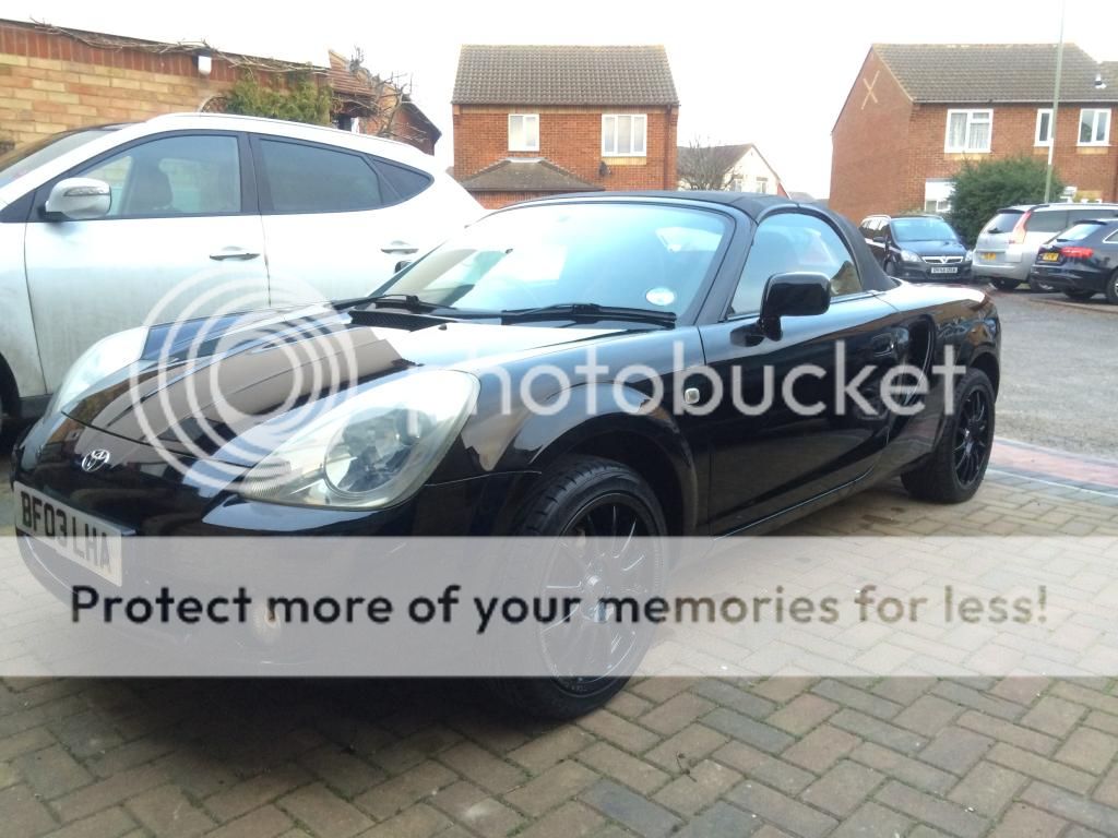

Finally got the wheels on, I quite like them
#29
Suit the car! Could take it rallyX with those arch gaps! Did you order some miesterR coilovers?
Sadlebag
#30
I'm number 8 so having to wait the 12 weeks for them to come back in stock. This pic was taken after a drive to so the suspension has settled as well! The tyres in the front are 195/45/16 and 215/40/16 in the back, beginning to think I should of gone maybe for a slightly bigger profile!
Sadlebag
Oh also no spare wheel in at the moment so front is a little lighter!
#32
The facelift cars were raised by an inch so it's expected. Coilovers will look great
