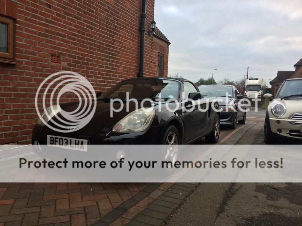

Quote from: "Sadlebag"
Only just realised, mine's also a black 03 plate. Do like the alloys you've picked up.
2ZZ-GE converted 03, black, TRD bodykit + scoops, hardtop, Meister R coilovers,  TTE exhaust with sports cat, Apexi PFC + TTE style bar & Rota Subzero 16\'s
Sadlebag
#51
I think Patrick has ordered most of them parts for me / got them on his shelf!
Mine is a bit tatty on the bumpers and bonnet but it was cheap and I plan to change the bumpers at some point to!
It will keep me busy for a while. Well once my foot puts itself back together anyway!

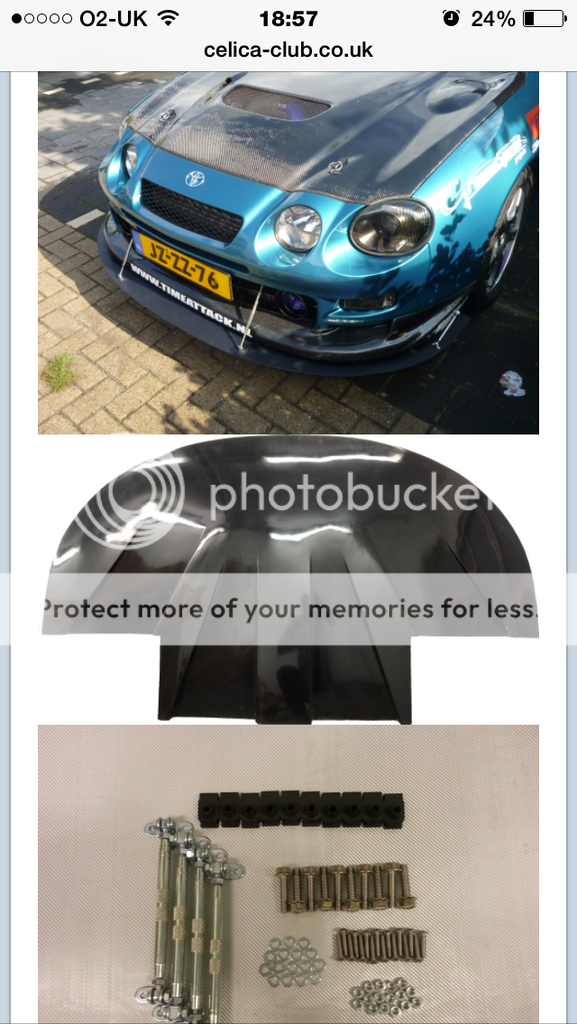

El creation front bumper and a TRD rear valance!
Front splitter with built in under tray!
And finally wilwood brake kit for the front!
This has been proven to increase front end grip!
Most of this is going to get fitted after it comes back from Patrick but it's gearing towards being track ready for Japfest!
Guess you'll need to trim it down a lot to fit the bumper?
Sadlebag
#58
Yeah it's been designed so you trim it to fit
#59
Ok, be interested to see it
MilesH
#60
Have you got a link for that front splitter by any chance? I've just been looking at flat floors and considering what would be best to do.
Do you know if it is properly effective (i.e. you can stand on it?)
Sadlebag
#61
Quote from: "MilesH"Have you got a link for that front splitter by any chance? I've just been looking at flat floors and considering what would be best to do.
This is his ebay page.
 m http://www.ebay.co.uk/sch/superray23k/m ... _ipg&_from m
Message him on their and ask if he will make you one, I got mine from a member who decided not to fit his in the end!
