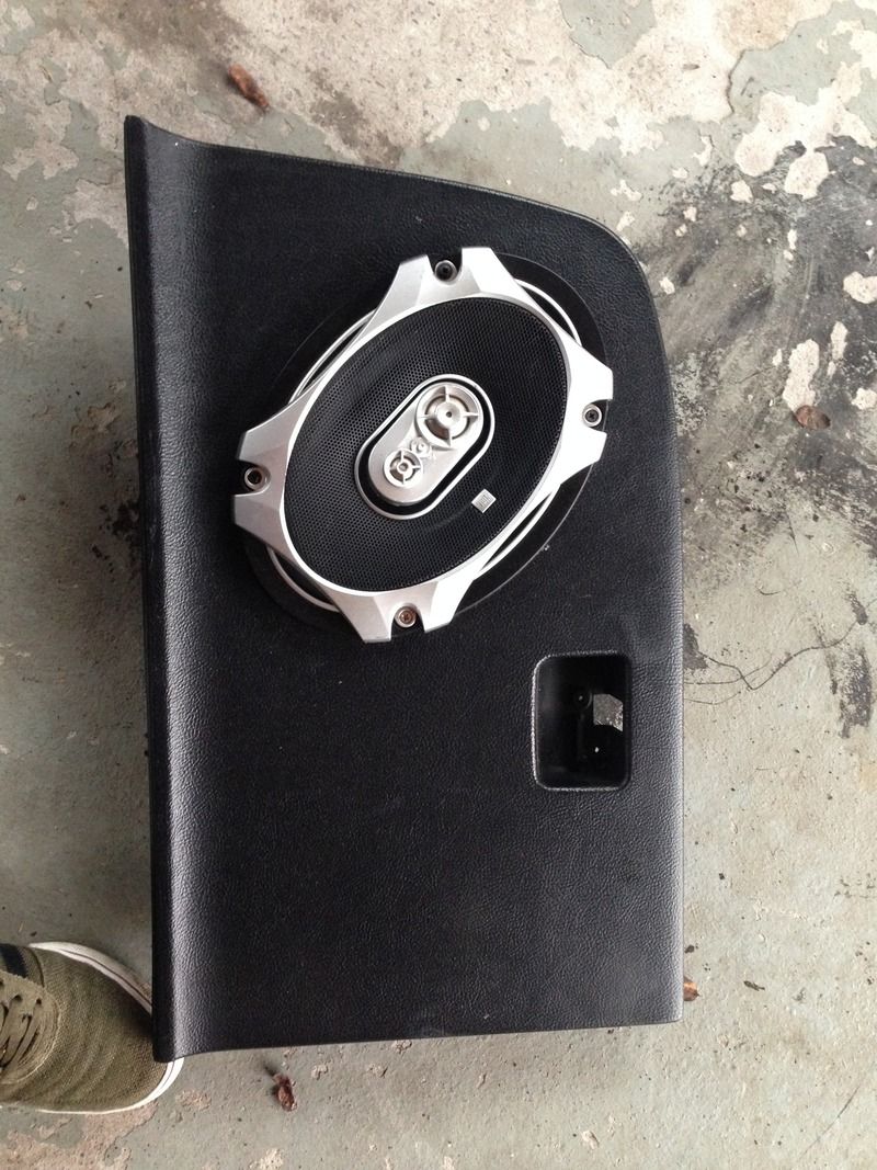

tomaky
Would this simplify things?

mickeyfish
that's it. spot on. gonna reinforce the back and use car fabric or carbon for the front face. got my eye on some soundstream tarantula speakers. I hope their not rubbish, I like the spider fronts. lol. tacky or what ha ha..........could also get fli sub. good contrast, or do I need to give my head a good shake.
