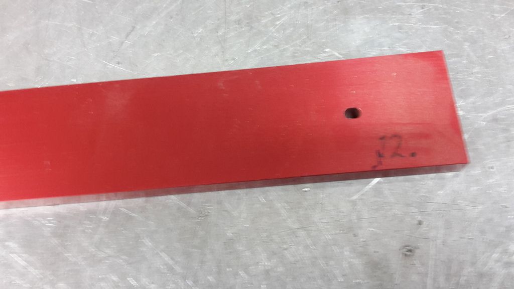

Then I measured how big I wanted the addition to be.
I just happened to have a nice piece of Alum the right thickness.

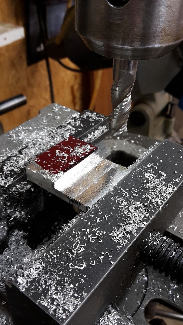

So I cut it out. The thickness of the pedal is 5mm thick and I wanted the pedal extension to be flush with the top surface so I needed to mill of 5mm from the 8mm thick alum block

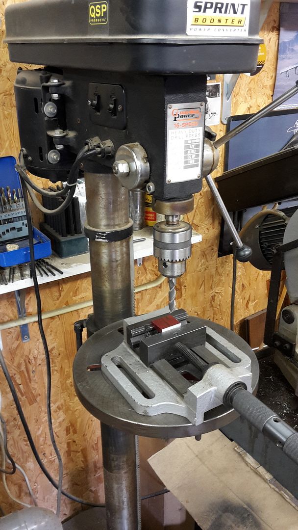

I put a milling bit in the drill press since I don't have a milling machine.
Then very carefully I milled the step in the block, it was not very clean but it worked just well enough.

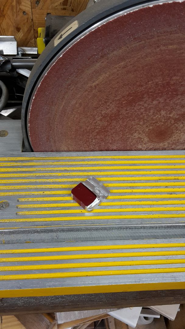

With the disk grinder I cleaned up the edges and rounded it off.

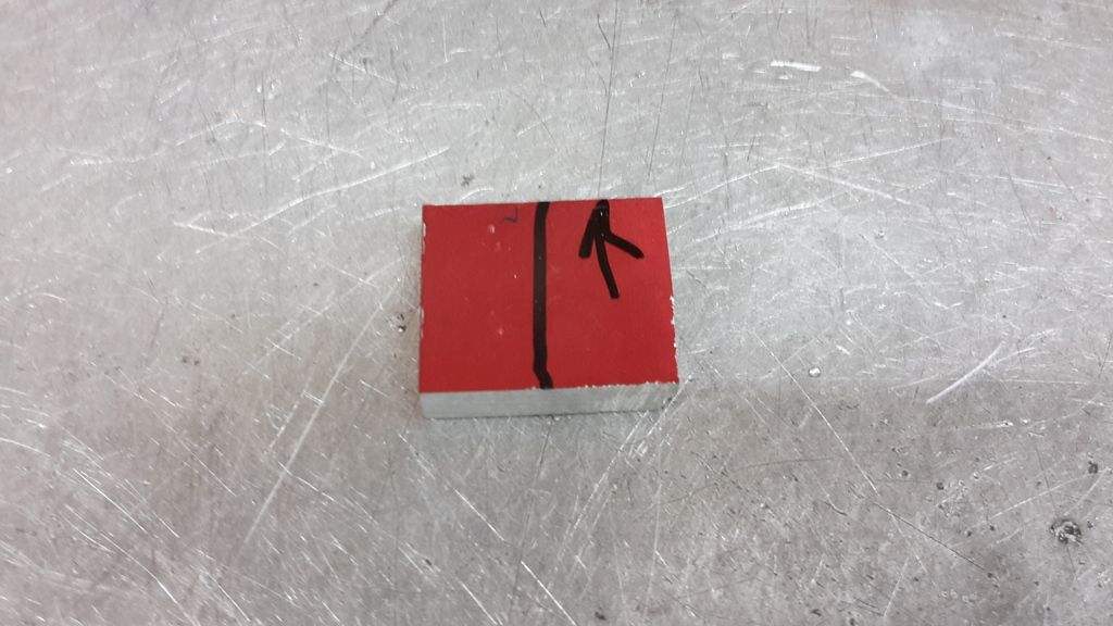

Test the block in place to make sure it fits.

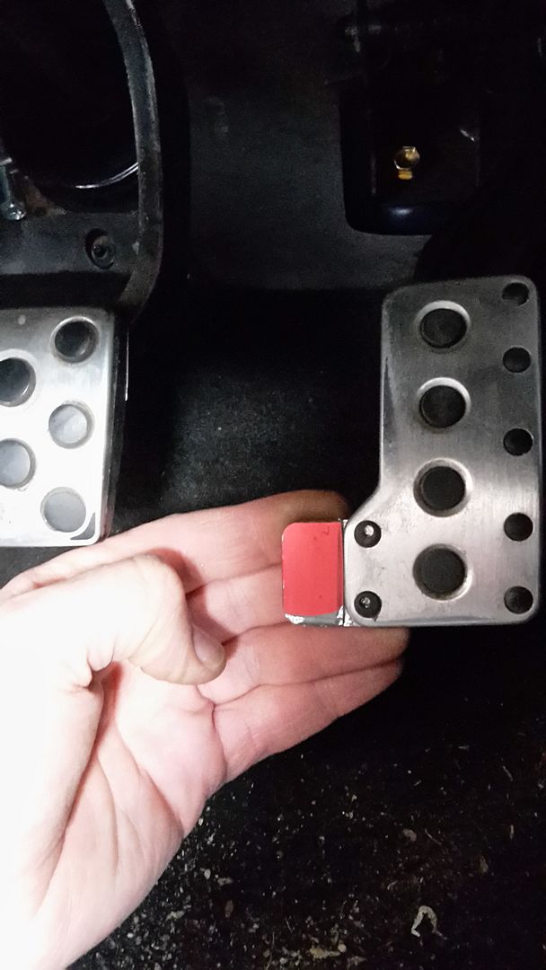

With a tracer punch, mark the 2 holes on the block and drill it out. I just happened to have the exact size rivets in my box of spare bits (never happened before).
Rivet the block in pace and test the car out.
It makes the double clutching downshifts very sweet indeed.
