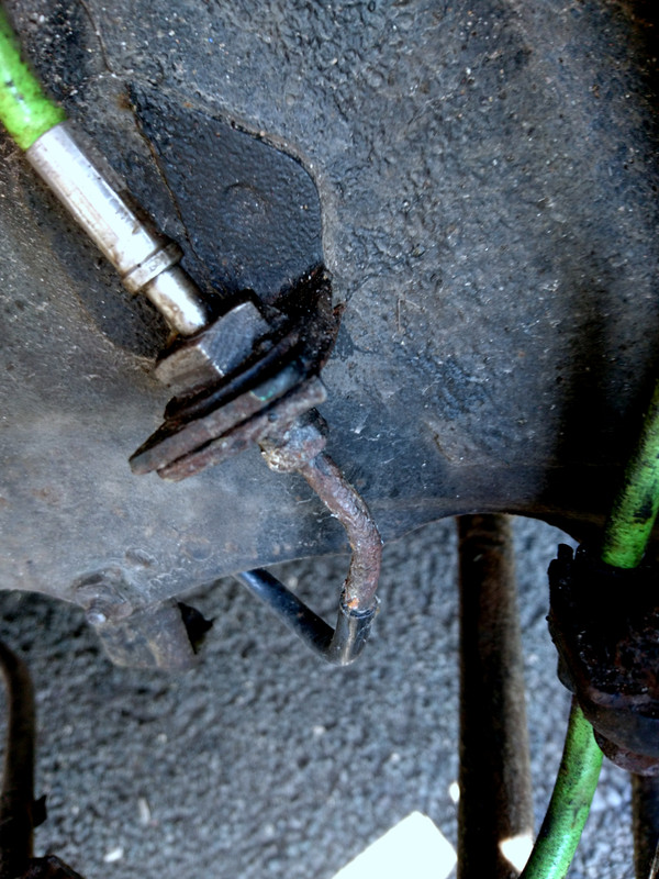

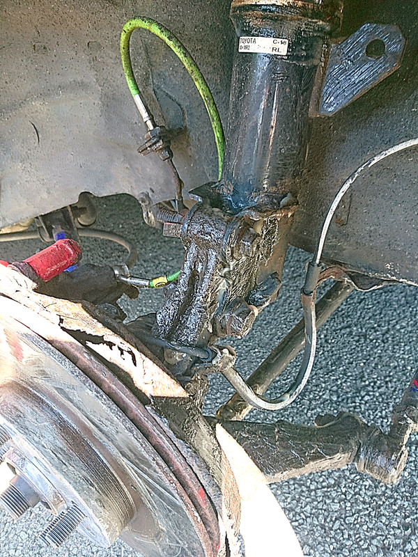

Will this be Mana from Heaven or am I about to spend another day practising to be a pitlane wheel changer?
24 hour delivery at no extra cost.  Excellent start.
Anyone wondered that Toyota might use orange steel to make the "underside bits"?
All to be revealed!
1MZFE, Emerald ECU, LSD, BC coilovers, custom middle & front under brace, F / R strut brace. Slotted discs & yellow pads, Blue flame exhaust.
Carrera leather seats, Davids bars, Focal subwoofer & voce speakers & bling !
TRD Stage 2 F & R spoilers,  Haltezza bonnet, C1 side vents, JDL rear panel
MR TWO
#43
Well its on the two corners that have seen off the other products.  This stuff has the texture of soft lard which for younger people is similar to I can' believe it not butter than has been out of the fridge for some time.
The instructions suggest keeping it out of the sun so I've put the wheels back in place the give shade.  The transformation from orange to silver is estimated to require  one to six hours. I'm hopeful!
Sometimes with car repairs, when its not going exactly (or at all) to plan, I get some doubts in my mind about my skill levels. I question whether the job has become FUBARed merely due to me instead of some cosmic conspiracy to thwart what is right and fair.  Of course this doesn't last long as its naturally someone/ something elses fault.  Still this time I know its not me - any idiot can slaver on gloop and if the marmalade colour is still there afterwards its down to the product!

wotugonado
Depending how bad the amount of rust is, someone recommended leaving for 24 hrs but slapping the stuff on and wrapping cling film over it to stop it drying out, every now and again giving it a massage through the cling film to stop it setting.

Yes I remember reading that advice too - from Frogger or Arch Bishop I think. I expect to have to give it a second dose (although I would be so pleased if I didn't need to to).  The second  and and final (?) would go on overnight and thats when I will wrap it up.
Three hours or so to go until I get my first look. Early confidence (for no real reason)is beginning to wane...

Bossworld
Quote from: MR TWO on May 22, 2018, 13:23
Forgive me asking, what condition is that last inch of hard brake line in?  Has it got the gloop or copperslip on?

Hi Bossworld,
Ask anything you like and make any suggestions you think are good too.
Do you mean this bit?
Solid condition, will be better with a coat of paint.

Well I just had a look at both front and back after 6 hours.
The surface of all the rusty metal is now coated with a hard very dark brown/ black layer.  I used a file on it and broke through to mostly shiney steel.I've just whacked another lot on the worst affected areas and will give it a drill powered wire brushing tomorrow morning. Maybe it doesn't need it, but just to be on the safe side.
I see aerosols of zinc primer & Hammerite paint in my future. Finally.
This product cost £17.89 delivered for 1 Kg which will be enough (with a little spare methinks) to complete the whole job.

Bossworld
Quote from: MR TWO on May 22, 2018, 16:15
Hi Bossworld,
Yep that bit about an inch or so long where it meets the union after the plastic coating ends. I couldn't work out if it looked a bit bumpy or not from the pic. I've just renewed both of my fronts because of pitting on the pipe, had originally coated it with hammerite after failing an MOT but had a nagging doubt in my mind.
Cut into the pipe afterwards and it was still solid but it's one area that mot testers love to be picky about.
