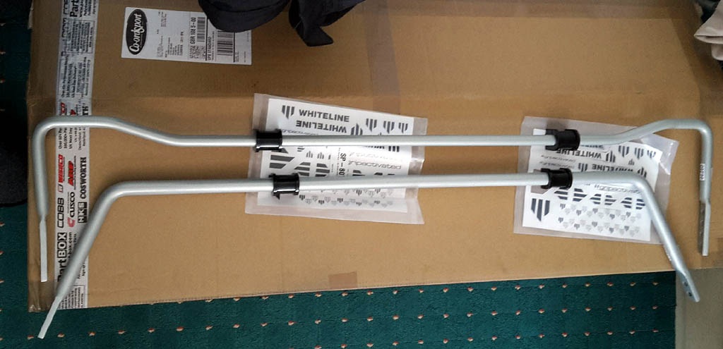

OK managed to source a pair of Whiteline ARB in stock at Coordsport (part-box.com) and they did me a great price on individual bars as I missed out on the kit price by 1  day!  its good to see someone actually holding stock on site these days as its become such a rare thing!, I should have them here tomorrow so that's Saturdays job :)
Still need to get new front drop links as TCB and GT4-play both haven't replied to my enquires so probably just pick up from local motor factor today.
Also sorted the snapped bolt on front mounting, basically I cut/ground off the captive nut with the snapped bolt in it, luckily there was enough room to get in from side so I could use my reciprocating hacksaw to cut off most of nut and grind rest with dremel, I needed to open the access hole up slightly in bracket but not much so all is now ready for new bar and bolts etc.

So they arrived today great service from Coordsport :D   look a whole lot better than the rusty oem bars thats for sure!...should get them on tomorrow :)
