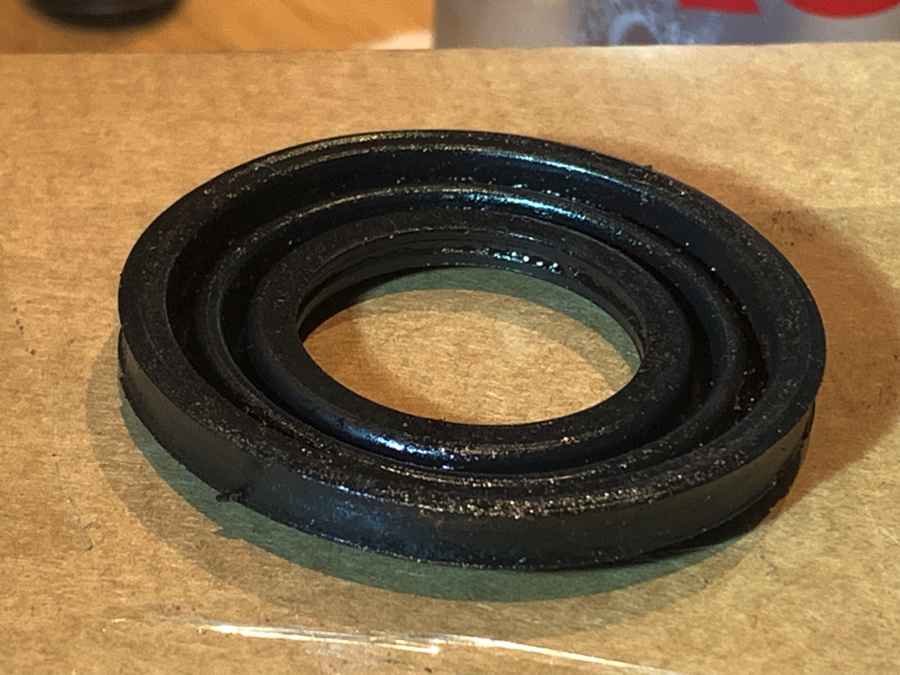

Only snag I had was when rewinding the piston on the second caliper, I must have caught the rubber seal as it started to weep oil

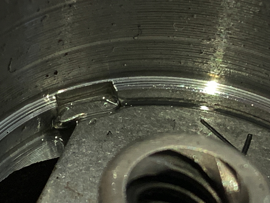

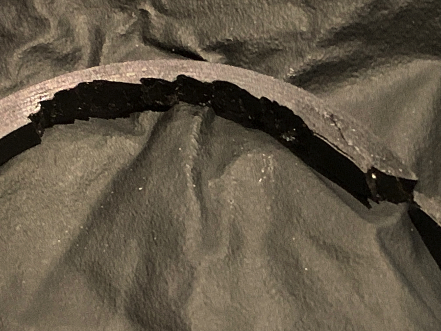

Apologies, it's the bellows looking dust cover that I was referring to, when I was winding the piston back I grazed it and oil weeped out,

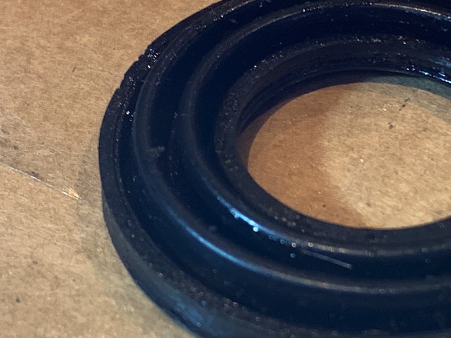

now you mention it, when I took out the actual rubber seal ring it came out with ease and it was already sapped and on closed inspection I noticed it had been what looked like chewed, Mr T replaced the pads back around 2010
Being my wife's car she used to take care of the servicing, if I remember correctly that was also the last time we took it to Mr T as while fitting the pads they phoned my wife saying the car needed all it's disks replaced (at an extra cost of £399 in 2010 money) as the disks were 95% rusty, it was at this point I drew the line and told them to just fit the pads and we never went back for its servicing, playing with un-knowledgeable peoples fear of non working brakes
Looks like the mechanic didn't take too much care when fitting the piston in to it or was already damaged before fitting
I noticed there were rubber particles in the barrel once I took out the piston but didn't cross my mind where this came from

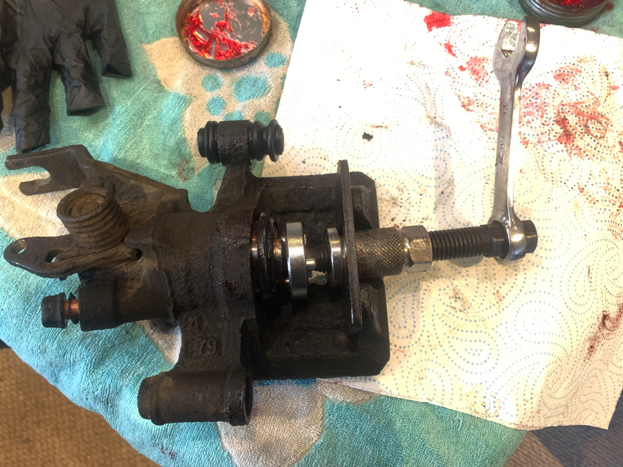

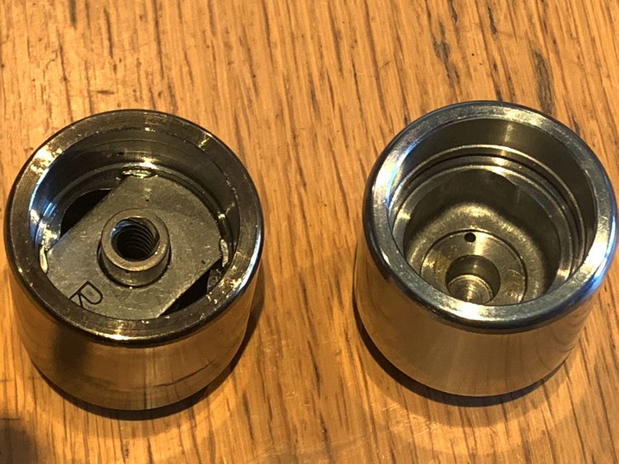

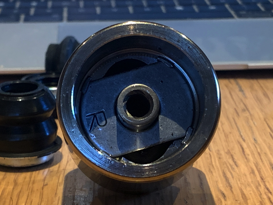

My new seals and piston arrived this morning, one thing I noticed is the new piston is minus the screw innards as shown in the images below, any idea how to remove the innards from the old piston and in to the new one?
(New on the right)
May thanks
@Mollydog
I had hoped you were aware of that.
To my knowledge I don't believe that can be done though maybe someone, somewhere knows why as they are offered by several suppliers!
I do know that a piston with the necessary is available at a higher cost than without.
Sorry, I can't recall which supplier.

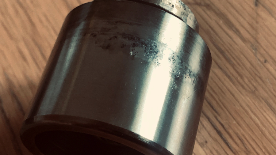

Clean up the old piston with some 400grit wet and dry and use that.  It will be fine.  I've rebuilt a few of these and never used a new piston.
It's doable but you have to cut the original piston to get the plate out and then hold it in place in the new piston with the big circlip that should be in the kit.
But if it's anything like the one I used then the circlip will probably fail and render the handbrake useless.
Either swap it for a new one with the plate pressed in or as Carolyn says, clean up and reuse the original...
Oh and if you DO go down the route of cutting the original plate out you'll need a "special tool" to refit all the mechanism held in place by the pressed in plate.

My pistons were beyond redemption when I got them out as Imwas less than careful because I intended to replace the pistons.
But once out and looking at what was offered I realised there was a problem
I looked again at Brakeparts , they do not show the inside of the piston, but their piston is £23 or so and may be correct at that price.
I would ask the question of them.
As CTM advises
there is no way of doing it as OE !
I'll do as you say Carolyn, looks like the factory one is meant not not to come out

Thanks for this info, another reason for using the old piston, I'll keep the new piston as a souvenir and polish up the old one,  shame they didn't explain this in their eBay add,

Glad i saw this before attempting to fit the bigredd o/h kit i have. Just checked and the piston is empty as above...

I now note that there is indeed a circlip slot in the replacement piston, but as CTM mentioned his did not hold the supplied circlip,  so not a lot of use.
When I was looking for my replacements I noticed that the replacement pistons offered were generally without the hand brake mechanism.
At that time I did see pistons offered with the necessary so, hopefully still available somewhere.

Hope it works out for Mollydog but I do doubt the longevity of the new seals on the surface of those old pistons.
Yes those do look quite pitted.  Try Paul at TCB performance parts.  Best to phone.

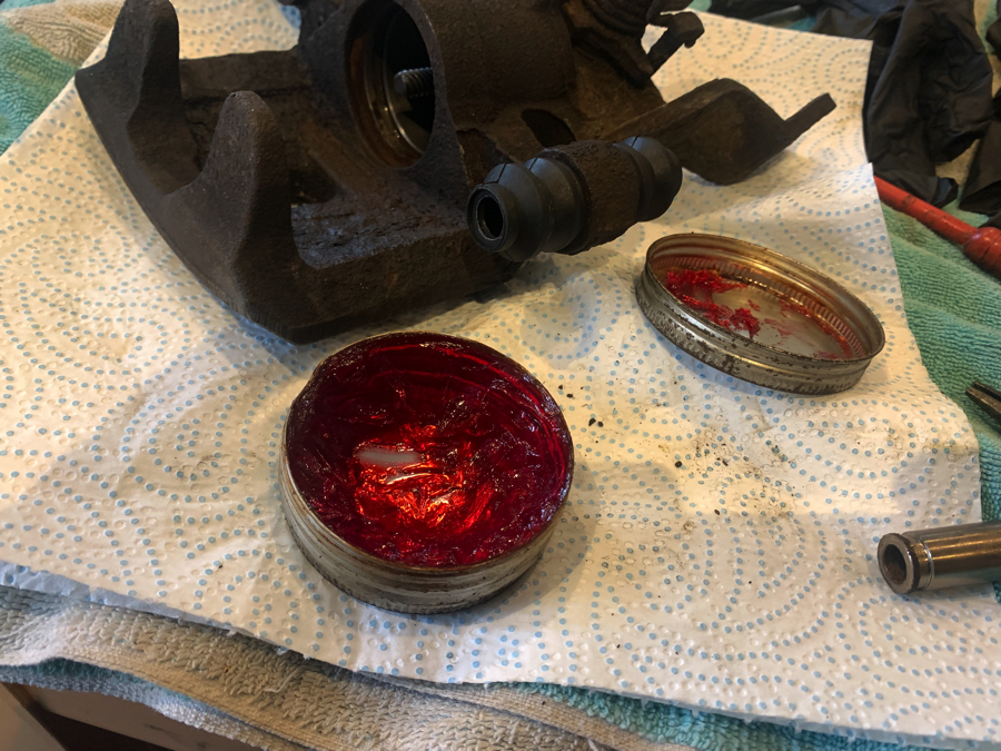

If these seals last me till summer then I'll have the car up on axle stand in the summer and buy proper pistons and seals and do it again (for the sake of a few more quid) I got out my small tin of Red Rubber Grease and after a dry run I went over the parts used with a good dollop of RRG
Made sure the seal ring was seated comfortable
I didn't spare the horses with the RRG
I wound in the piston before attempting fitting the dust boot in to it's slot

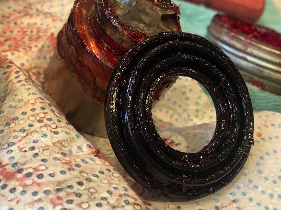

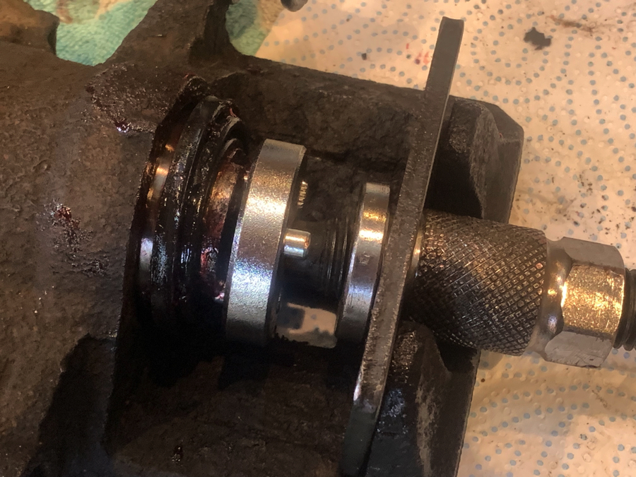

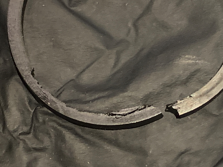

I've more or less lost the will to live trying to fit the metal ring round the dust cover boot, I just cat see me getting it on, is this  crucial part needed to be fitted?
If it is then I'm taking the complete caliper to my local (Indi) garage and pay them to fit the ring
I use a dental pic to manipulate the ring.  Persevere - you'll get there.  Might be easier with a little less grease!!
It keeps all the road grit and dirt out.  It's not unsafe per se, but your repair won't last long.
Quote from: Mollydog on December  6, 2022, 15:34would it be safe not to fit it?
I believe you would be back to where you are now even quicker.
I would try backing off the piston to give you some more visibility.
in this case I'll have another try in the morning, then if I'm sucsefule I'll pop down the local garage to fit the metal ring for me
just had a thought... Have you got the dust cover the right way up?  it has a lop on the outer fold that takes the ring clip.
I thought I fitted it the right way,  I fitted it this side up facing the top, the side you see when looking at the piston
And this side facing down, can't be seen when looking at the piston from the top
Fitted to the piston
That's ok.  Screw the piston out so the bellows are extended, then you can get at the lip the ring clip has to go in.  Then screw the piston back in.
just to report back, I think I was doing it wrong,  it's firmly seated in now so will fit the calliper back on the car in the morning
I was going to give up but for the encouragement on here, it made me persevere, once I got one side firmly down the other side seemed with a little nudge to just slide in
