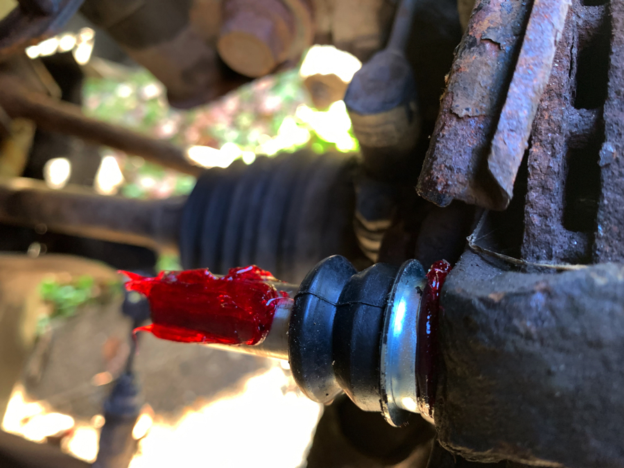

Red rubber grease on the two moving parts on the calliper

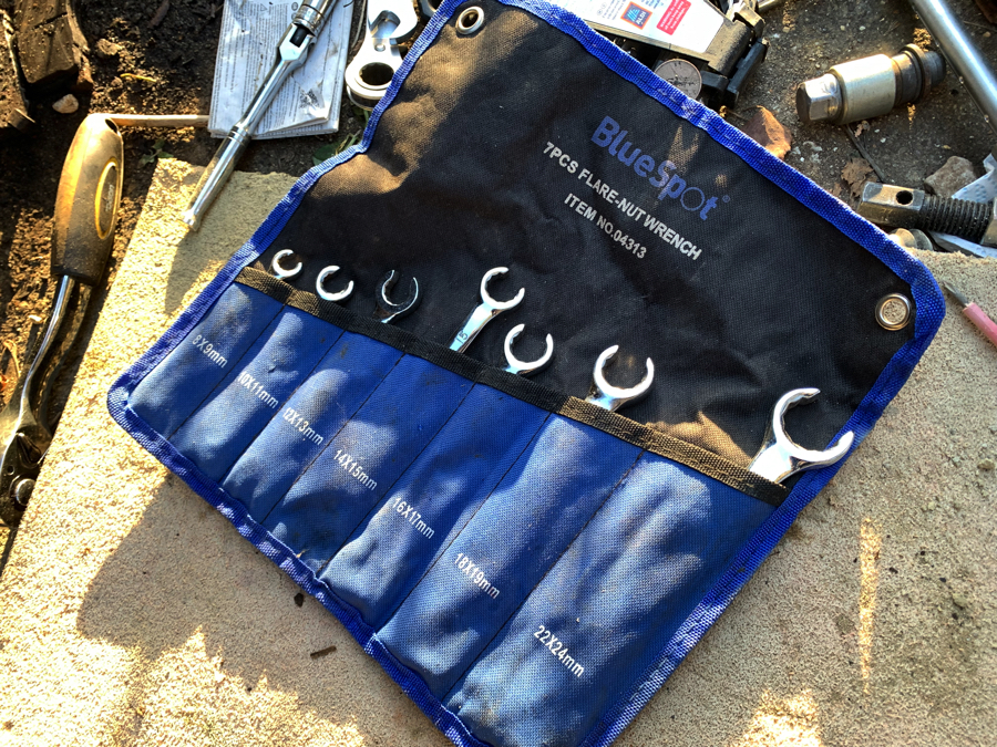

Tools at the ready to bleed the clipper

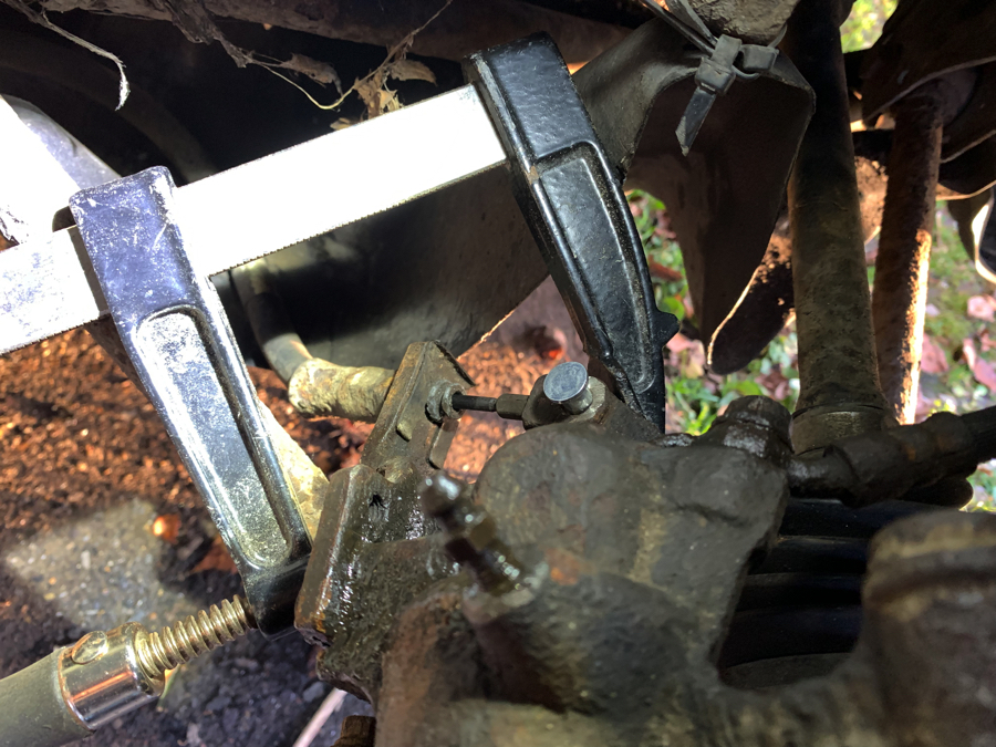

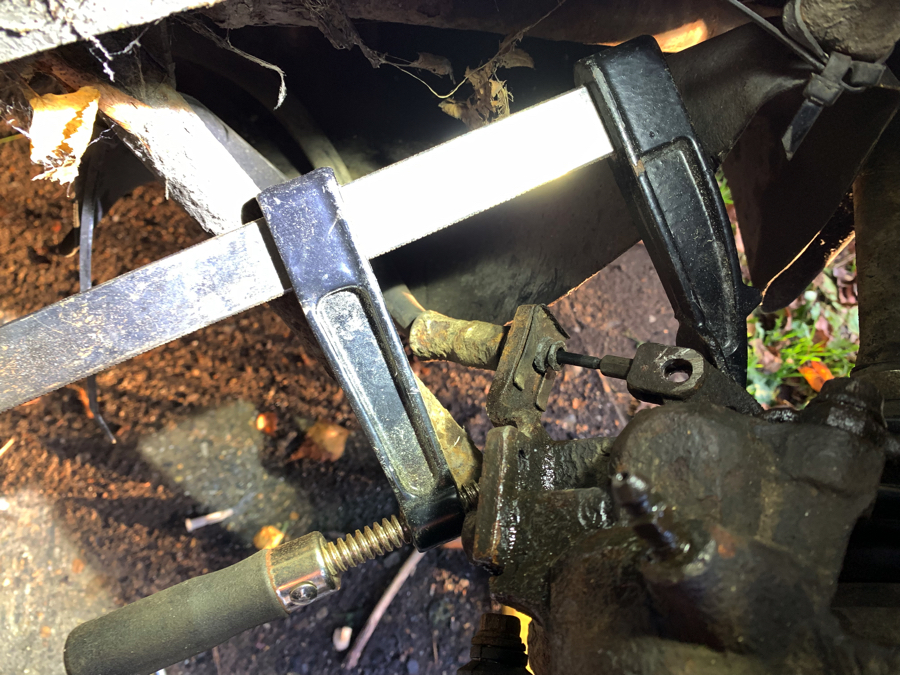

I've heard and read/viewed (YouTube) how very difficult it is to re assemble the brake cable to the calliper at the Clevis Pin hole, so I used one of my F clamps, this made it very easy, in fact I had to un tighten the F clamp as I had it closer to the hand brake cable than was needed
The Clevis pin just slid in with very little pressure
All the way in
Topped off with the split pin
I bought the Clevis pins from Amazon around £8 for 12, I don't know what to do with the extra 10 yet
You will need to slacken the handbrake cable all the way off in order to set the brake properly, so connecting the clevis under tension is really not the best approach.  Hey ho!
Red rubber grease is also not really meant for sliders.  May I recommend some 'Ceratec' or other silicon grease for that job?
But - hey you're doing it and that's a good thing.

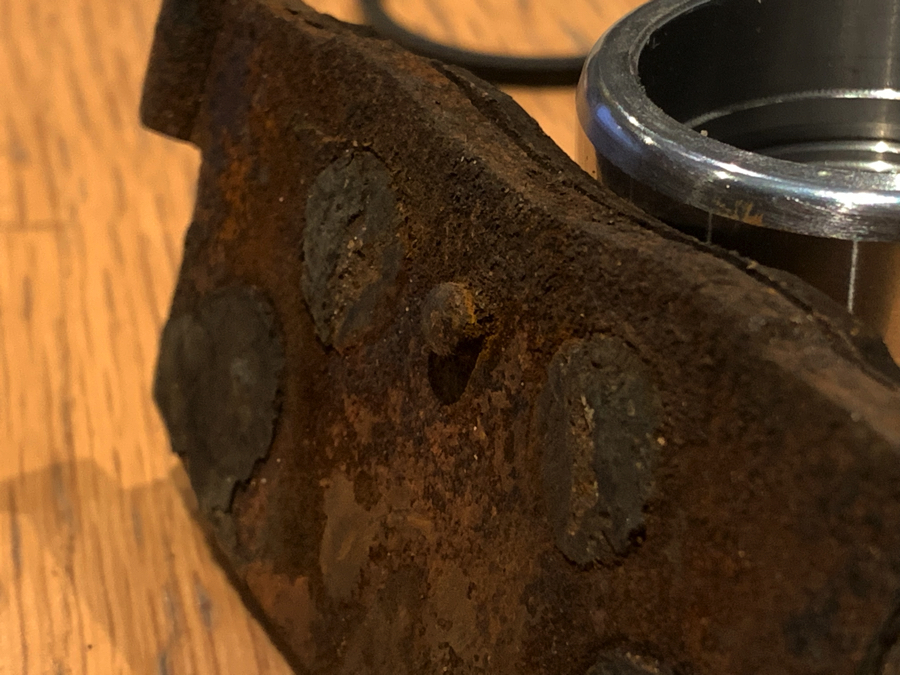

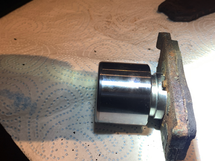

One thing has me a bit puzzled, in this image I'm using the old pad to show what I did
Viewing YouTube I made sure this pin on the inner pad
And the slot on the piston lined up (like this)
now I'm thinking how is the piston able to wind out as the pad wear down, would it be due to the large gap in the piston slots?
The rod it screws onto rotates.  A bit like a screw jack.
If the piston could rotate it wouldn't work.  Hence the slot and nipple to prevent rotation.

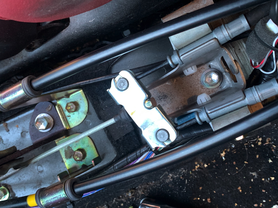

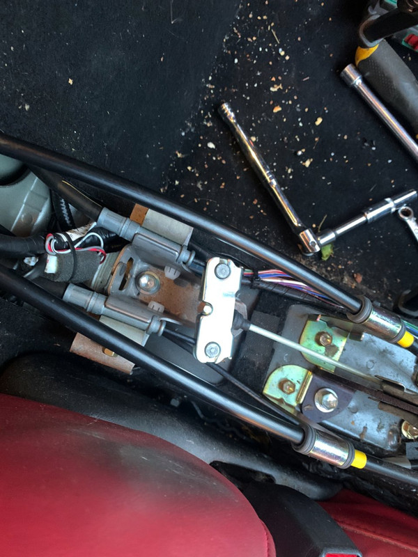

Made a start on the car this morning, the cable balance leaver was tighter to the near side cable as opposed to the far side (drive side) both when cable was slake (brake off) or tight (brake on) would this be an issue?

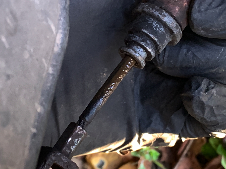

Both my exposed part of the cable ends at the callipers don't have the rubber boot/covering,  I noticed when pulling the cable out it was damp/water around the cable, I don't know if all cables are the same but this has it's wire strands  covered in a plastic sheath
I did as Carolyn mentioned and un clipped the cables at the calliper end and pumped the brake peddle 20 times firm but at a steady rhythm
I finally adjusted the hand brake cable to get five clicks (is this a good choice or should I go for 6 or 7 clicks?) on the handle but the balance leaver still to one side,  I presume both cables are the same length
On my last MOT I was told my off side hand brake passed but was slightly weaker than my near side
Here's my YouTube clip of my cable and the tools I use to lift the car on it's axle stands
https://youtu.be/zDuWloLGw0I
As you can imagine. The saddle should be balanced.
Sadly, something is not right there.
Cable length?
The offside cable is stretched.
When I've come across cables that are wet inside, I've disconnected them at both ends, making sure the bottom ends are pointed down to let the water drain, then (while working the cable back and forth), dribbled WD or the like in from the top until the WD appears at the other end.  Then repeat with light machine oil (3 in 1) until that oil appears at the other end.
You can get cable-end gaiters that are for the MGF that will squeeze on with some lube and effort.

Thank you for this advice, I'll go over them tomorrow with the WD40 followed by the 3 in 1 oil down the cable
