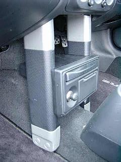

This is how my central console looked after taking delivery of my Roadster. Very bare and not much happening in the entertainment zones, but I must admit a nice finishing on the two upright pillars.

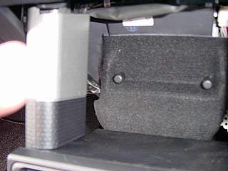

The two inner covers are the easiest to remove, with your index finger run your finger up the back of the inner cover until you find the recess. Pull the cover forward and it will clip off.

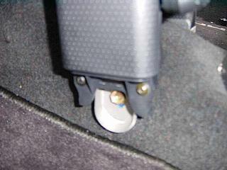

The larger outer covers need slightly more effort to remove. The lower, light grey, cover needs to be pulled away from the central console, to expose two screws and a single bolt. Undo the two screws bur NOT the bolt.
Pull down on the outer cover and it should come away easily.

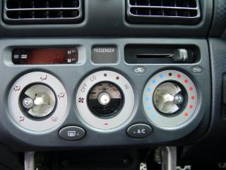

The next job is to remove the heating / Air Con control facia.

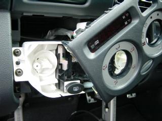

Remove the slider handle and the three control knobs. Behind the left and right controllers are two screws, remove these. The panel should now be free to be removed. Pulling from the bottom, ease the panel away from the dash, you may find it necessary to give extra leverage at the top edge with a small screw diver inserted above the control facia and the main dash
Be careful when removing facia as there are still wires connected to the rear of the unit, to power the clock.

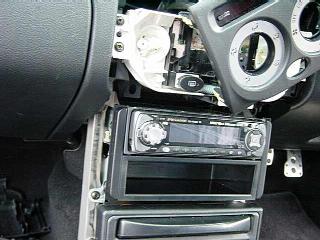

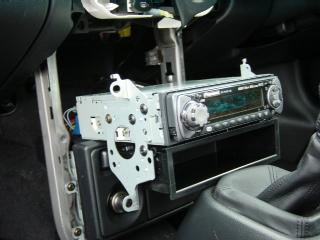

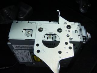

Fix the left and right mounting brackets to the head unit. Modern stereos have a standard set of locating dimples and screw points, so (nearly) all units should mount easily. It may take two, three or four screws per side to suitably fix the unit to the brackets.

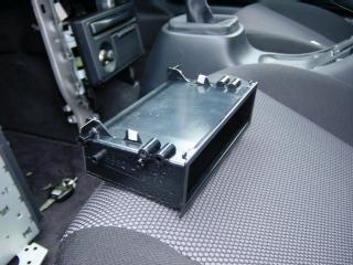

The craftiest part of all, the Celica storage tray. Yes this part is intended for a new Celica.
There a numerous mounting points on the unit, but it needs to be slotted in-between the newly attached brackets on the head unit. The mounting hole on the top of the unit just behind the first hole is the one we need to get aligned with one of the holes on the brackets. Only 1 self tapping screw is needed per side, as the brackets have locating points which match up with some of the other holes on the tray.

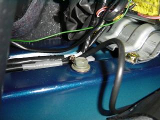

The hardest part was locating the antenna connector, it was eventually found tucked down beneath the carpeting on the drivers side. The coverings behind the central console pull back very easily and after a bit of investigation you should spot a cable running over the side and away under the carpet. There is about 15 to 20cm of cable terminated in a standard aerial connector. Fold the carpeting back round behind the console and fasten the Velcro tabs.

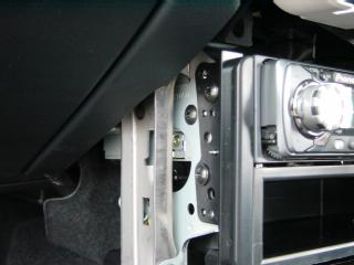

Now for the clever bits. As the standard head units available are a predefined size, these is going to be a gap at the edges of the stereo, since the Toyota unit is about 15mm wider on each side.

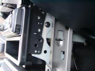

Fear not, Mr. Toyota has already though of that, the two plastic spacers are fitted to the front edge of each bracket to fill the gap. They just clip on over a small meta tab in the bracket. I had to undo two of the stereo / tray mounting screws, fix on the spacer then refit the screws.
Screw the hole assembly into the central console with four self tapping screws.
Clip over the surround trip (not shown on this image for some bizarre reason), before refitting the heating / Air Con facia, as the surround clips behind it on its top edge.

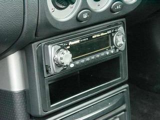

This is how, it should look when it's all finished.
To fit the stereo from scratch took about 30 minutes.
For those who are interested, the unit is a Pioneer DEH-P6100R CD Tuner see here for more details.
