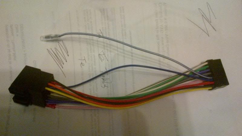

In the middle of fitting a sony single din unit and the aerial stays up as soon as you turn it on, even if you are playing through the ipod etc. Is there a way round this please? The standard wiring went straight in to my aftermarket stereo without need for a 3rd party adaptor which was unexpected, maybe as the pre FL stereo is sony also?
Also, I bought a facelift surround to use with the aftermarket single din fascia, but the tabs at the bottom of the surround seems to be getting in the way-I have looked at some guides but still don't understand how it all fits back in?..
Where I am up to. . .
2 lots of wiring, 1 came with the stereo, another came with the stereo kit incl the fascia. Not sure if I need to use these to solve the aerial problem
Markb
The aerial wire is the blue with a white stripe (also known as the remote wire for amps etc)......you need to cut it and extend it a bit and fit an inline switch to break the connection........you can do the wires now while you are in there and pick a switch up later,just tape the ends for now.
****edit....just found a Sony lead here......it has a loose blue and white for an amp......the solid blue beside it is for the power antenna.....top row 3rd from right?
chris3boro
Quote from: "Markb"The aerial wire is the blue with a white stripe (also known as the remote wire for amps etc)......you need to cut it and extend it a bit and fit an inline switch to break the connection........you can do the wires now while you are in there and pick a switch up later,just tape the ends for now.
If I am happy for the aerial to always stay down do I just cut the wire?
And is that for pre facelift cars by the way?
Markb
Quote from: "chris3boro"
Read the edit above.........if you cut the wire from the unit it should be the Sony lead you are cutting
On the first lead on your pic follow the loose wire marked amp.....cut the solid blue beside it.....power antenna should be wrote on it.
chris3boro
None have anything written on apart from the orange which says 'lumination'
Markb
Turn that lead around.....blue wire 3rd in from right....should be the blue your thumb is on
chris3boro
Quote from: "Markb"Turn that lead around.....blue wire 3rd in from right
The one at the tip of my thumb? Cut it and the aerial stays down?
Markb
Yeah.....better with a switch though in case you ever want the radio
Should be from top right....black,red, blue.....cut the blue
