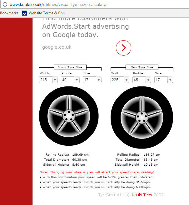

Looks like about 15mm additional on the radius. Couple with the slightly wider tyre, may indeed cause a rub. How much lower than stock are you?
