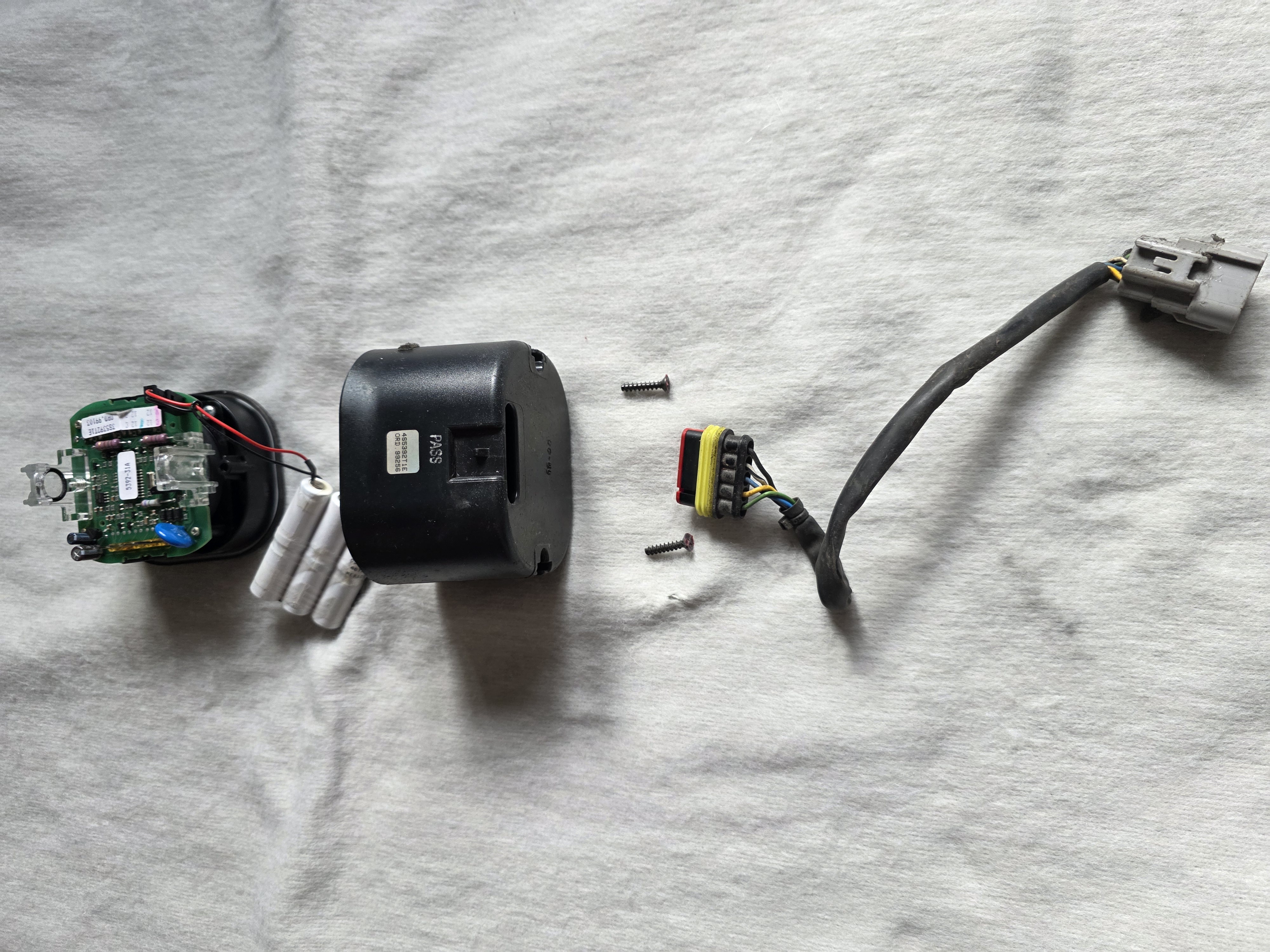

I had a similar problem recently where the battery would discharge over a short period of time (1 or 2 days if unused), even after installing a new battery.
I traced the problem to the car alarm. The Horn body holds 3 rechargeable batteries that no longer hold a charge and was constantly drawing power from the battery. Having removed the alarm batteries I no longer have problems with the main car battery.
Worth checking out  ;)

Stripping the alarm horn is straight forward
1) remove mounting bracket.
2) remove waterproof multi plug.
3) remove the 2 Philips screws and pull apart housing. you now have access to the rechargeable batteries.
If replacing the batteries, you will need 3 @ approx £20 each and reuse the connector to the PCB.
To date, I have just left the alarm horn off the car and everything works fine (but no siren)   8)

I Googled it.  Power back up for the alarm if a thief 'stops' the 12v supply.  There's a seller on ebay selling 7.2V packs,  so it looks like the above is correct.
