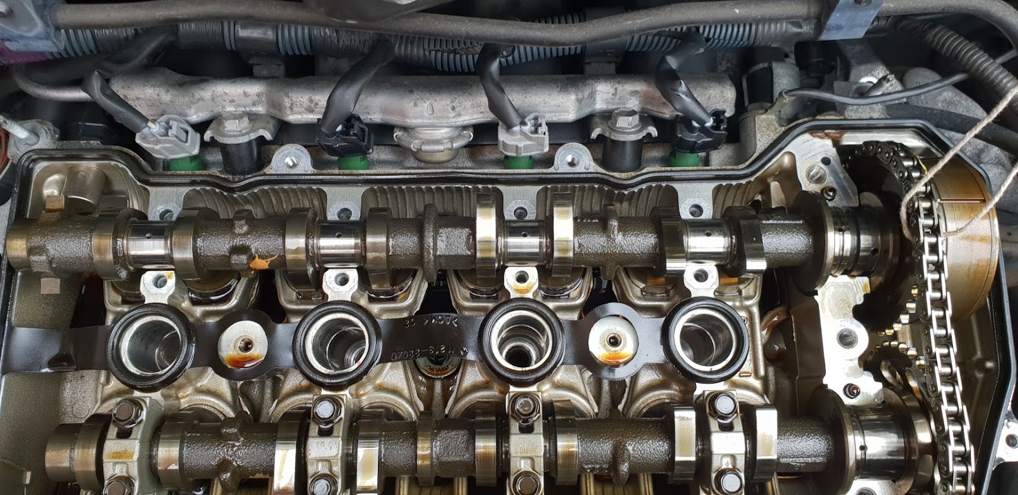

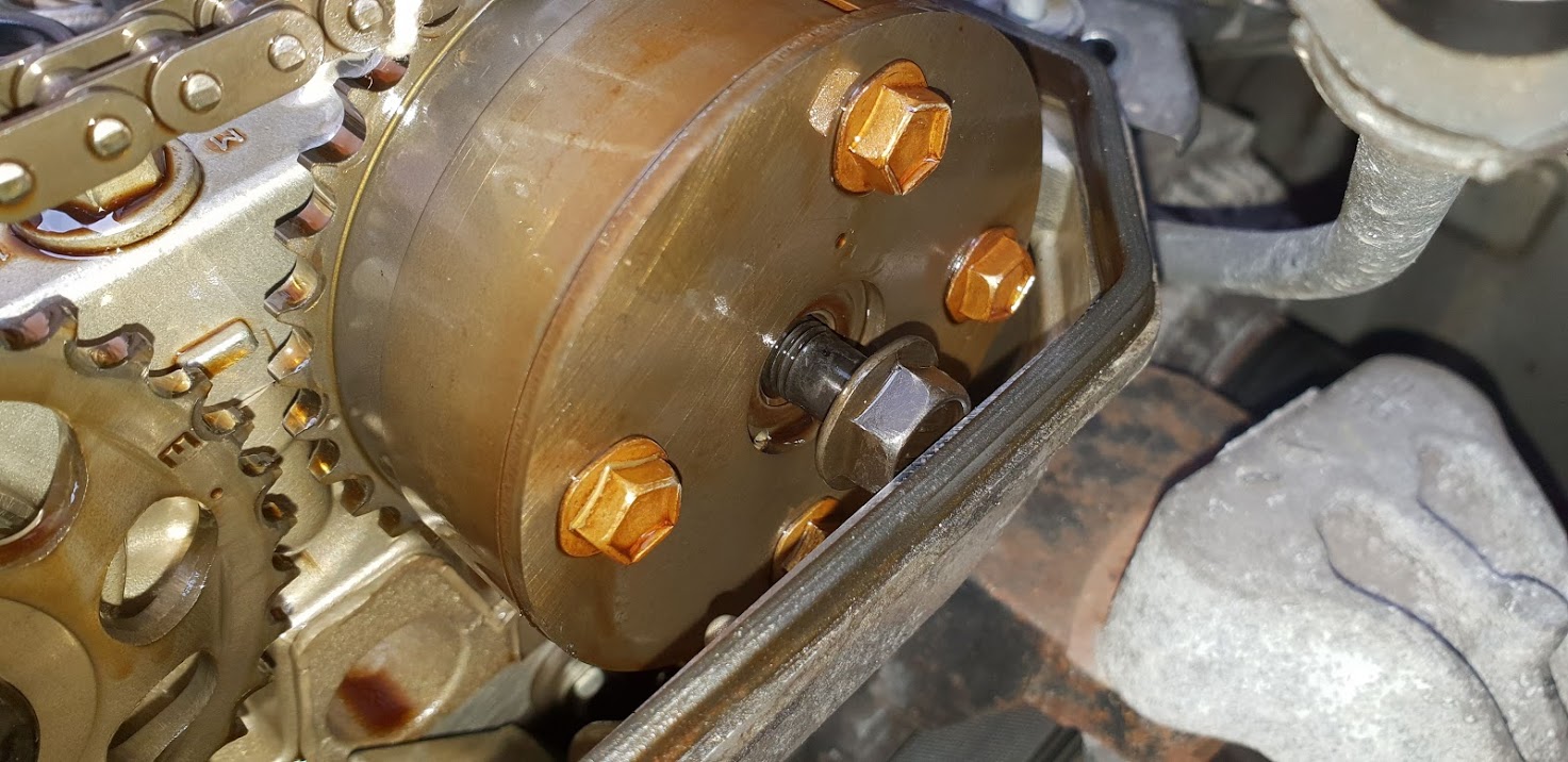

Finally got some time to actually do something today as need to replace my timing cam cover gasket anyway... Don't think that's possible without lifting the cam, bolt is too long and not enough clearance:(
got this far, then the rain started  :'(
Still got to remove exhaust cam sprocket, lift intake cam and then replace VVT hub; have put timing cam cover back on with some plastic sheeting over the top (just in case) until it stops...
I take it by 'timing cover', you mean cam cover?
Yes, I see you DO have to lift the inlet cam.  No big deal.  you've done the hard part.  If you're worried about the chain position, mark the chain where it lines up with the slot on the hub.  Line them up when you put the camshaft with the new hub back in.
If you drop the chain - no big deal.  It can't move on the bottom sprocket and you can fish it back up with a magnet.
Have you removed the chain tensioner?  You should...
Tip: the gasket goes on the cover - not the head.  Wipe all the oil off the sealing surface when re-assembling.

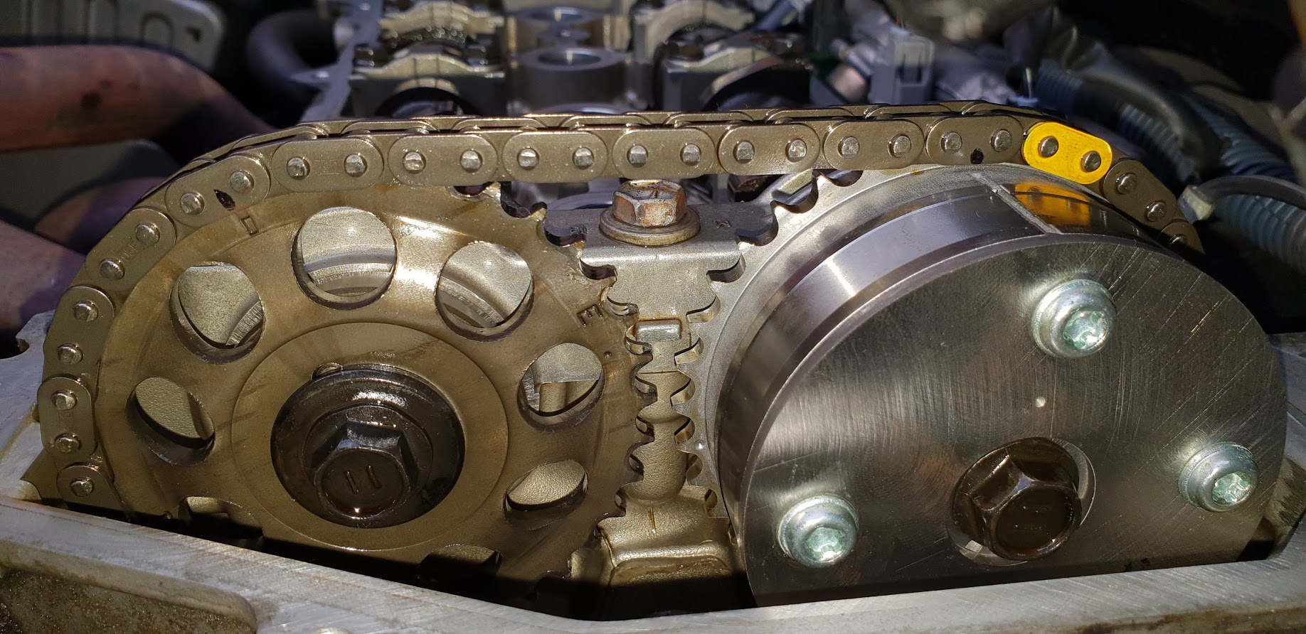

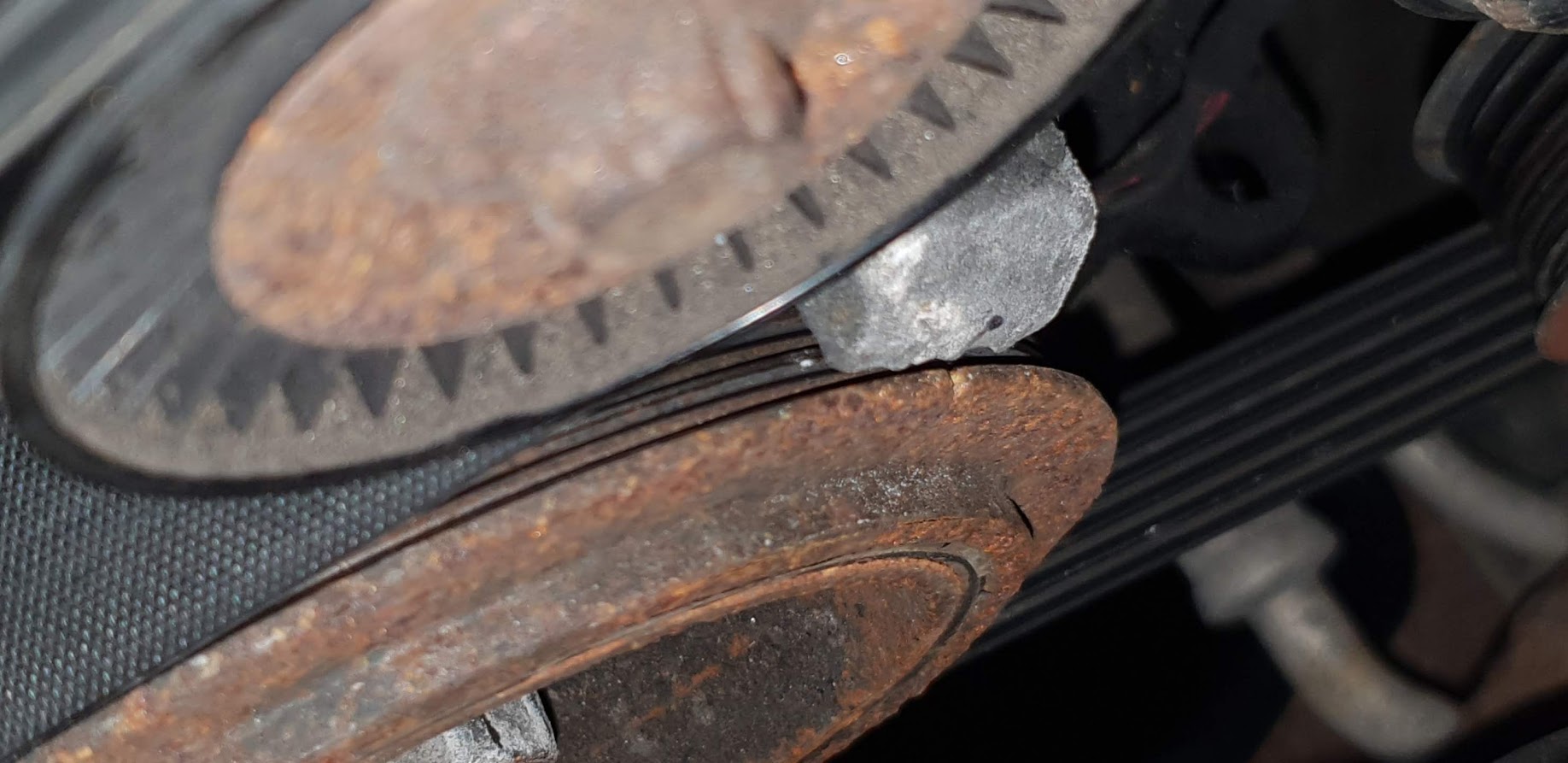

Had to abandon ship again (:< >:) Got my new hub installed on the cam (then locked), chain back with the marks I made lined up, but  the chain was too tight to get the exhaust sprocket back on so it cranked the VVT / pulley back (anti-clockwise) a bit and now can't get timing marks on cams and crank pulley to line up. Hoping some words of wisdom @Carolyn ? As you've said chain can't move on the bottom sprocket I'm not sure what could've happened? All good fun isn't it :) I'm hoping it's something I've been a bit stupid with which I can easily fix tomorrow.
Crank pulley grove lined up with mark on timing cover:
With pulley in the above position, timing marks now miles out...:
As per PM.  Inlet cam is a bit wrong and crank timing is using the wrong mark on timing cover - use the one to the right.  I think I might have said 'left ' in my PM.  It's the last mark the notch comes to as you crank the engine clockwise.
The inlet cam looks like it will be right if you line up with the yellow link and get the crank in position. Don't know how you got the mark a tooth off....
You'll probably have to lift the inlet cam again...  It's one tooth off plus not timed properly to the crank.  As per PM I'll try to assist by phone as you do it.  Exhaust cam looks good.....

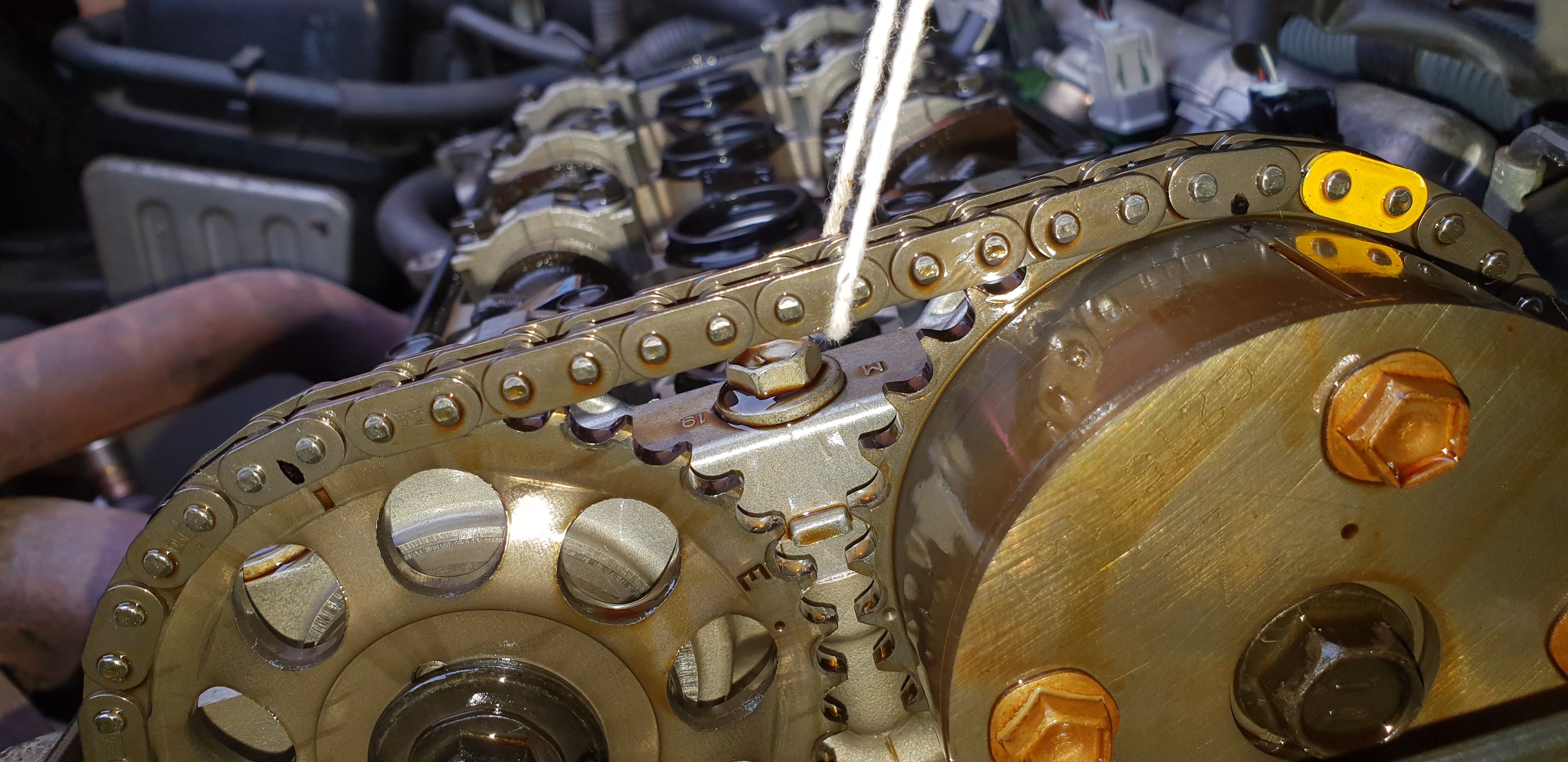

Quote from: CarolynThe inlet cam looks like it will be right if you line up with the yellow link and get the crank in position. Don't know how you got the mark a tooth off....
...also no idea how it ended up being one off, this was what it looked like last week when I made the marks, maybe I did something wrong on the crank pulley end last week:
Looks like too much slack in the chain between the crank and the inlet cam.  Should be taught when in position.  Use an adjustable on the hexagon on the cam to hold it in position.
I just keep looking at this.  Looking at the 'before' pic and seeing how the camera angle is working and then your pic, it just looks like the crank position might explain all.  It only has to be pulled round one tooth's worth of rotation to be right.
Edit:  Just noticed that it's an aftermarket VVTI hub.  Are you sure it's installed correctly?
Damn... I just keep on thinking about this one!  Can't get it out of my head.
AS per PM, I understand that the hub is Toyota and that they've moved away from the silly pentagon bolts, and I understand you won't be re-visiting this till next weekend.  But I just had to write this to get it off my mind!!
As the camshafts turn at half the rotation speed of the crank, and as the timing is obviously ten degrees out at the camshaft, the crank timing would have to be 20 degrees out to explain this. And it DOES look like you did a good job of marking the chain.  The line markings on the hub indicate the locked position too.
That only leaves (I think) the possibility that you have the pin in the end of the camshaft located in the wrong slot on the back of the hub. This is possible (and easy) to do.  I know you have been very careful and methodical, but I can't think how else it could be 10 degrees (One full tooth) out.

After a few weeks of wind, rain and early darkness I've finally managed to get the work finished and the car back running :) It was sorted out on the weekend, along with changing the front brakes but only started it up tonight.
Massive thanks for Carolyn for all of the help, turns out the sprockets somehow ended up being 1 link out from the marks I made at the start, so if I'd just left it how I had it on the 3rd Nov before I took the cam back off and moved the sprockets to the chain marks it would've been fine. Oh well, very strange!
