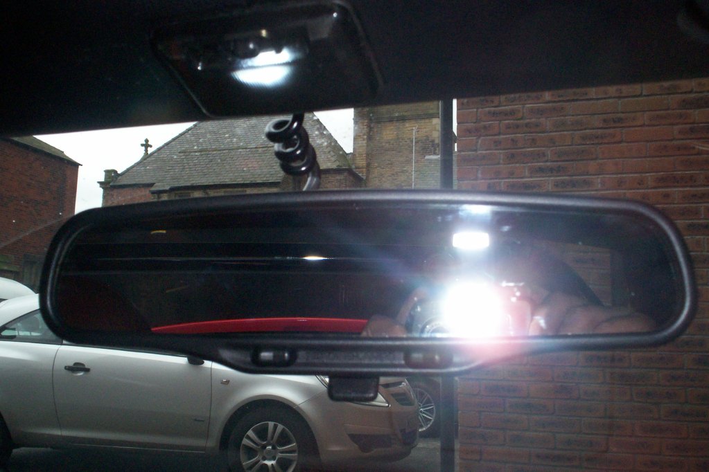

OK I fitted this mirror today,it took about half an hour taking it easy and I thought I would add a few pics and observations to excellent guide above.
The fuse is the 1st red one under the top blue one on the right hand side.
Screwdriver creating gap for wiring to feed through,I found I had to strip about 7cm of the cover to avoid interference.
Window slug,jiggle & pull mirror towards square edge which was towards dash on my car.
Wiring through interior light fitting.
Wiring soldered up.
Fitted and working well although I think I will replace the 39mm festoon bulbs with led type for cleaner light.
