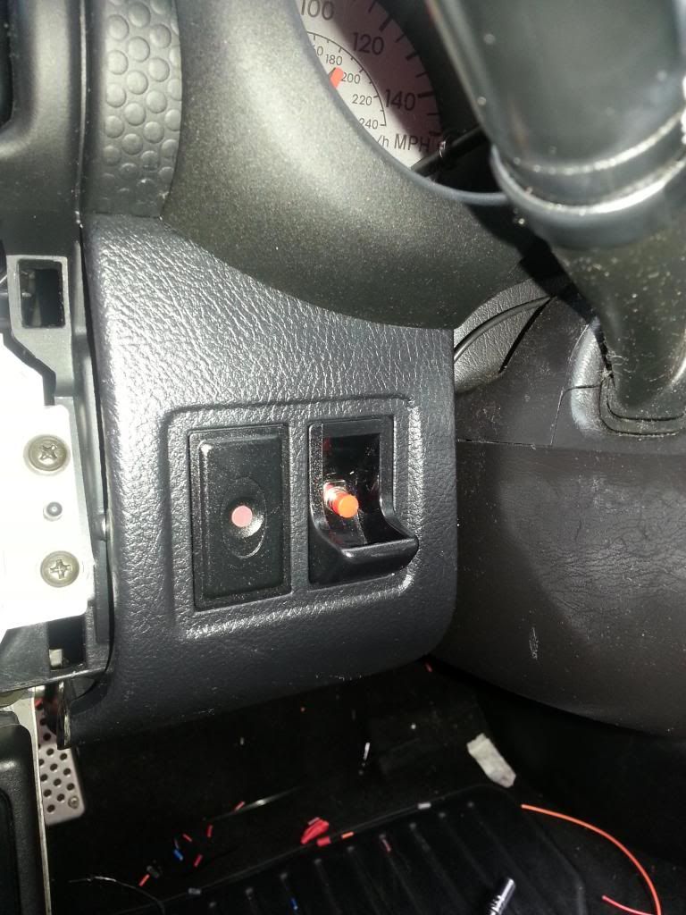

I was fed up with the aerial coming up each time I turned on the stereo as I rarely listen to the normal radio (either DAB or MP3) but wanted to keep the option to use the aerial so I wired in a relay and a momentary switch.  When the stereo is switched on the aerial will stay down, then  press and release the button and the aerial goes up and stays up until you turn the stereo or the ignition off, it won't go up again until you press the button with the ignition and stereo on.

Here is the switch fitted:

I just put an inline push on,push off switch on the blue /white wire (aerial/remote) on the aftermarket iso lead (to save cutting original wiring)......the easy option  s:) :) s:)
Quote from: "Markb"I just put an inline push on,push off switch on the blue /white wire (aerial/remote) on the aftermarket iso lead (to save cutting original wiring)......the easy option  s:) :) s:)
I did the same thing but got another electric window disable switch to make it look factory  s:) :) s:)

Fin
+1, I just put a switch on the central console.
