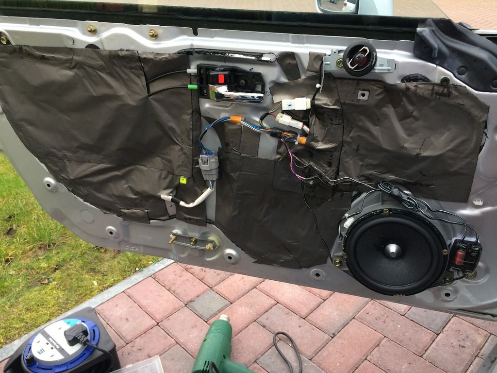

I have used Hi tac flashing from Wicks. You can also buy similar from Homebase.
Wipe down the area of the door you will be applying the flashing to with alcohol and try to a heat gun to help the flashing stick. I fitted the flashing to the outside skin within the door, then to the inside skin of the door.
Also check the speaker hole on the door card, as I maybe loose and cause vibration from the speaker. If so run clear silicone round the inside of the speaker hole.

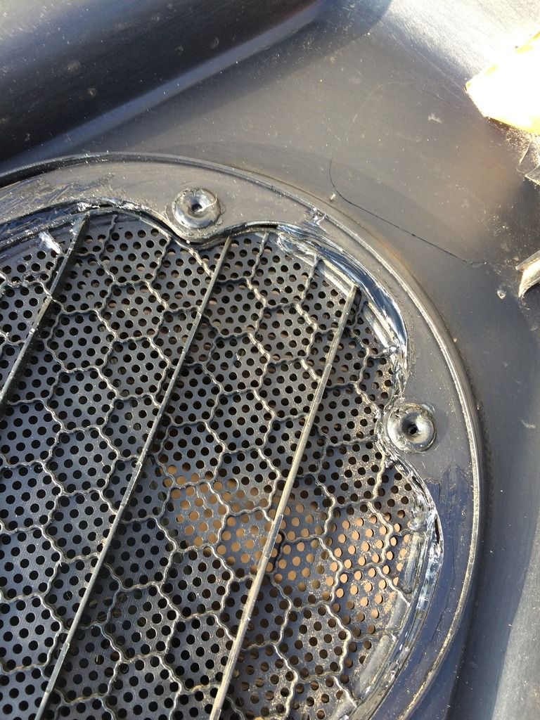

cheers, I need to double check the grills as most of the vibration is from here.
I see you have done most of the door which I was unsure if I needed too, will give it a bash at the weekend

i used flashing tape in the end. its done a great job to the sound. just a slight rattle on the passenger door that i need to find
