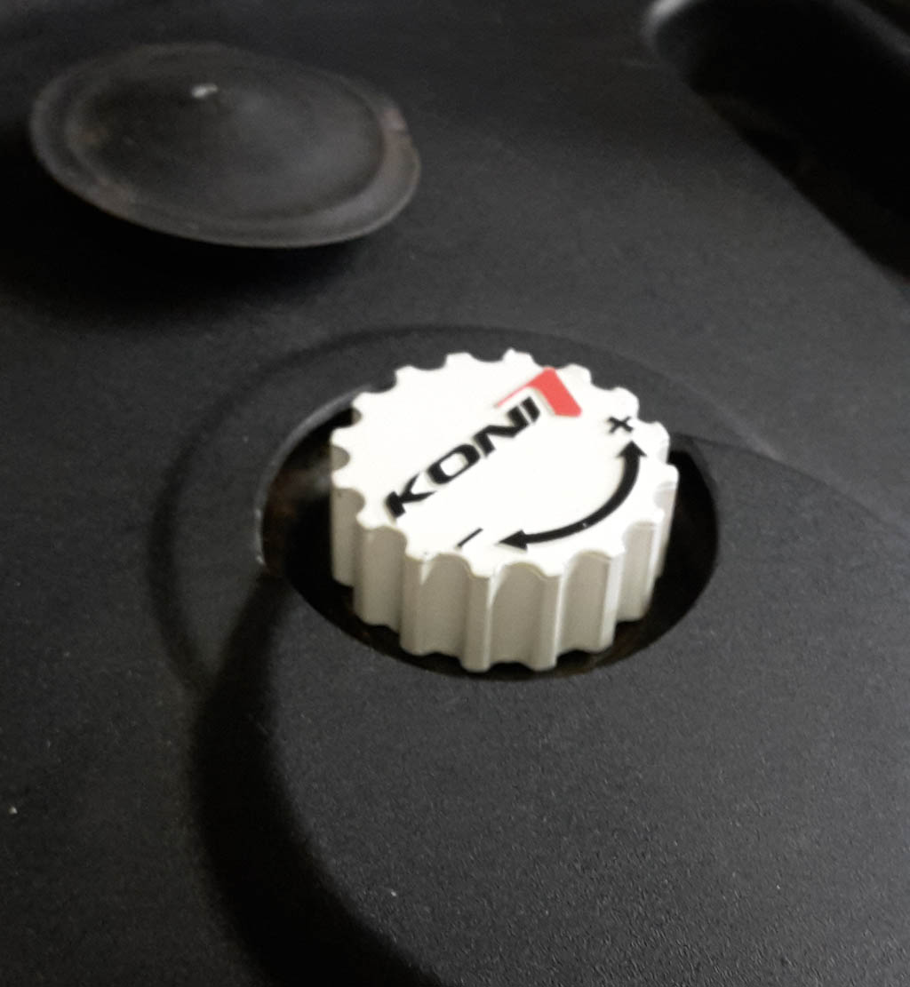

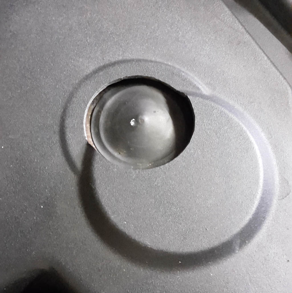

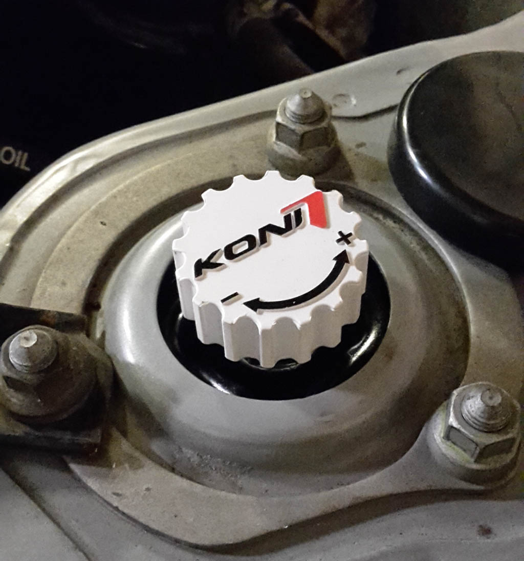

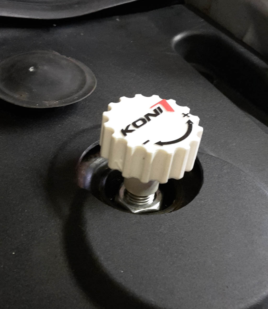

Anyone up in the north is welcome for a ride in my car anytime to experience the Koni/Tein combo, point to note for those that are thinking of this is you must shorten the Bumpstops if fitting Tein spring kit unless you want a bouncy ride, the old Tein instructions used to show this but for some reason they dont now, if you dont cut it the car will be very firm especially at the front as your basically sat on the bumpstop all the time, it should come into play and assist the coilspring on bigger bumps but you dont want it touching all the time, maybe if track only it might be good to firm up front end but i didnt have issue with mine and shorter bumps when on track last weekend and i prefer a compliant setup.
I took a couple of pics of the adjuster setup i have, first up front with cover on, you can see the rubber dust cap is accessible through the hole ive cut in frunk cover,  rubber cap  is touching the adjuster tab on damper but it doesnt cause any issue, i guess in time it might wear a hole in it but no biggy.
Next with the 3 different length adjuster knobs in place, i forgot i recieved 2 of each and have been using the shorter one which is a bit fiddly with frunk cover on, will carry both types from now on.
And the Rear, hard plastic cover clears the adjuster tab on damper so just remove it, fit on adjuster turn to desired setting then remove and refit cover, keeps it nice and oem looking :)
HTH
