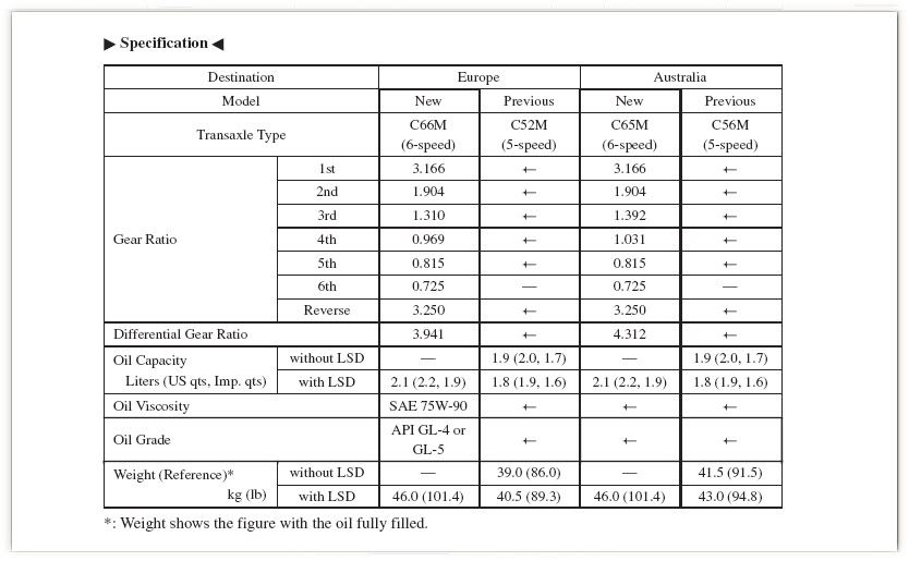

Gear ratios of UK and Australia models.

It seems Australia and JDM have higher gear ratios than euro afterall.
