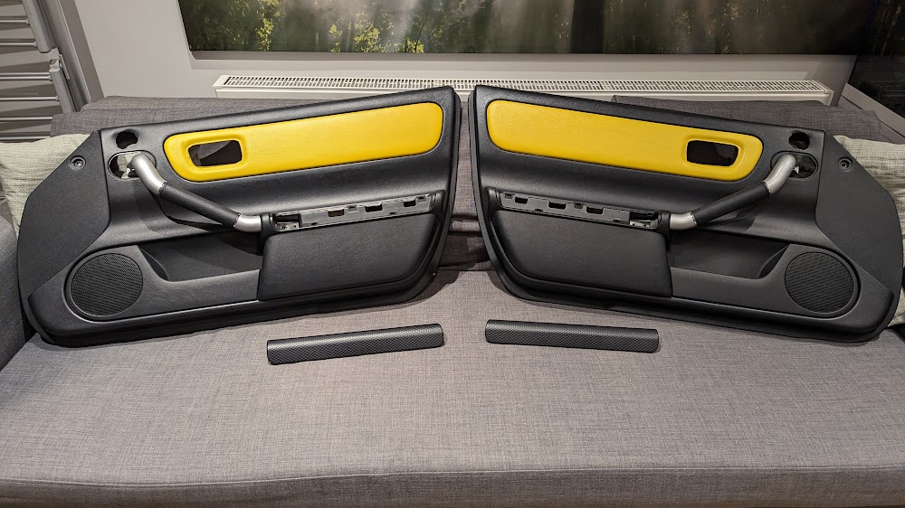

While waiting for the adaptors and the trim bits to arrive, I decided to start putting some work into the door cards.
First job was to reattach the speaker covers. It looks like the previous installer broke these off trying to do the install without removing the door cards, so the plastic welds were long gone.
I decided to do a bit of plastic welding myself using a soldering iron and some cable ties. It wasn't pretty, but it did the job and it means we can put things in the door pockets without them falling out onto the road every time we open the door!
Next I tackled the rattling trim clips. I've seen some like to dab some silicone around them, but because I'm lazy, I've used a trick that was oft-used on Ford Pumas - basically put some masking tape over the holes and then ram the clip in over the top - works a treat!
Then I set to with the sound deadening on the reverse of the cards. I find this really satisfying which is a bit sad, but hey, it is OK?
Finally, I gave both of the door cards a good scrub down with APC and then used some leather feed on the yellow inserts. I thought that these were vinyl, but they soaked up the feed so shows what I know!
And done!

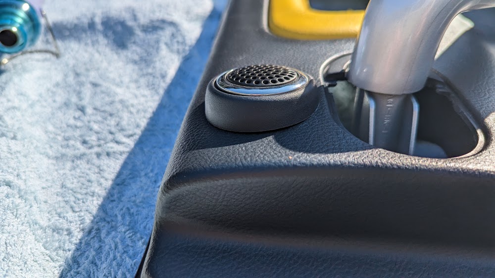

Well, this is a long-winded speaker install isn't it? Unfortunately, the speaker adaptors (due Thursday/Friday) have still not turned up. I noticed that the courier is Hermes, so the chances of it turning up at all are 50/50...
Regardless, my box of trim had turned up, so I excitedly fitted the OEM tweeter covers to the door card. But there was a problem with that;
Due to the last tweeters being fitted with what I can only presume was a mallet, it had distorted the plastic around the fitting;
As plastic has a memory of sorts (probably better than mine in my advancing years), I dug out a hot air gun and heated up the opening then, using the end of a mallet (ironic) I pushed it out from the back. It took a couple of goes per-panel, but in the end;
Success! Not perfect, but much better.
