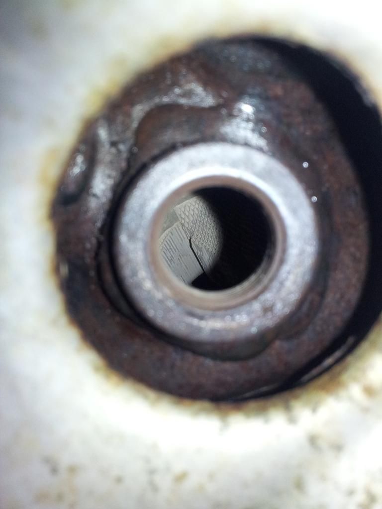

GT4thomas
#207
Mine look like this. Big power loss, struggles to rev
andyroo104
#208
There is not a lot left,hence your power loss. s:-( :-( s:-(
