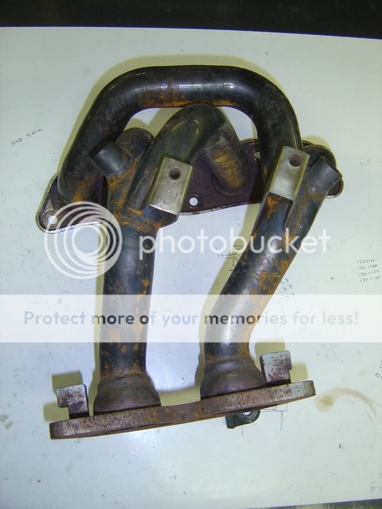

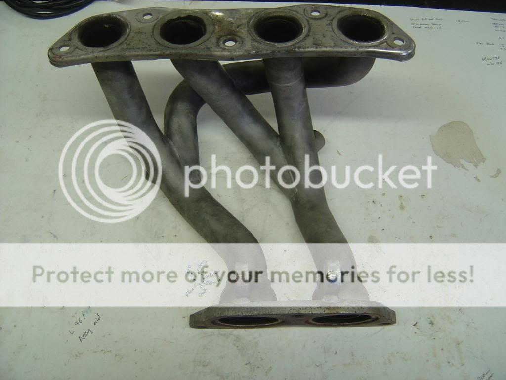

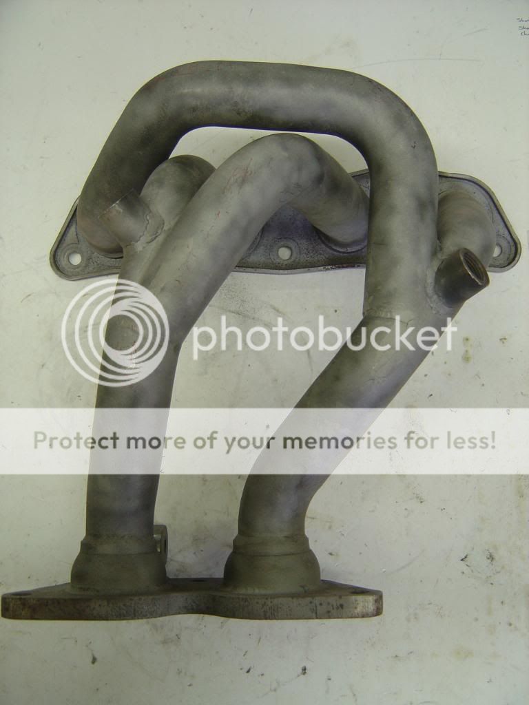

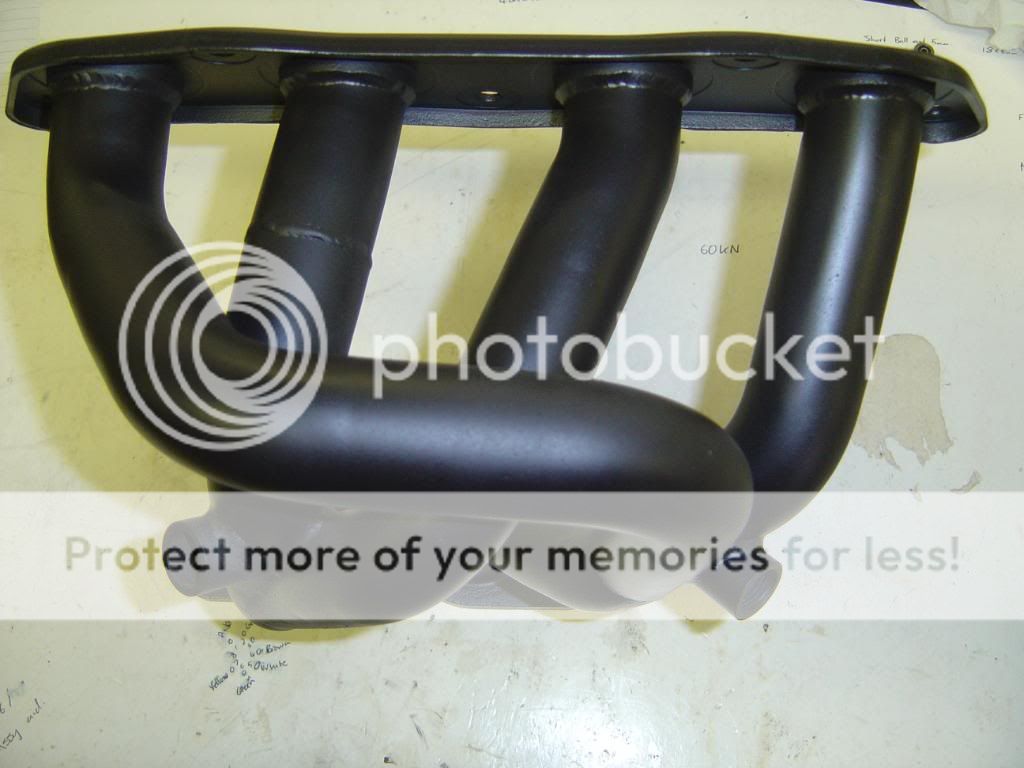

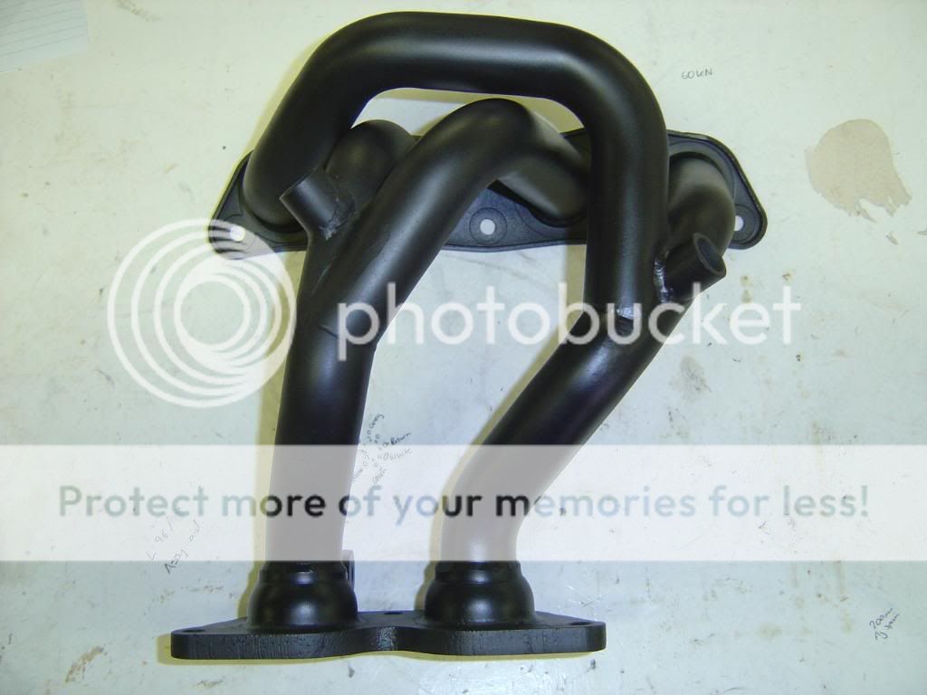

Not much to tell yet but should get exciting soon. I have been doing the manifold at work and am half way through.
Here is how it was, A little rusty and not looking very nice.
Heat shield lugs removed and sand blasted.
A coat of DEI high temp paint.
Hopefully get it wrapped this week.
