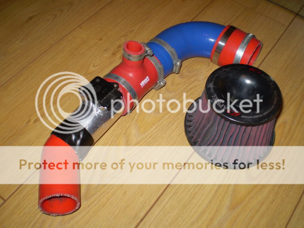

Hasn't stopped me spending though  s:roll: :roll: s:roll: .  As the curious scenario of the original MAF position and poor running seems set to remain a mystery I decided to plough on with the MAF in the new position post turbo as everybody says that's better.  Following the installation the plumbing post turbo ended up being an interesting collection of various sizes and colours of silicone hose, clamped with many jubilee's and at the new MAF point bonded internally with sikaflex and then gaffer taped  s:crazyeyes: :crazyeyes: s:crazyeyes: .  So I decided it was time to get dressed.  All new hoses, t clamps instead of jubilee's and properly reduced from the TB to the turbo pipe (ID70 to ID51 through a series of ID63 connections for the dump valve T).  In addition the existing Apexi power filter was looking a little tired and as the kit is knocking on 6 years old (although only covering around 20k in that time) time for a new one (in chrome  s:wink: :wink: s:wink:  ), this also solves removal of the original MAF.
Check out the before.
And the after.
You'll also notice new injectors, 310cc EU 2zz, cleaned and flow tested (thanks Tem  s:wink: :wink: s:wink:  ).  New sparks, BKR6E's (£6.68 delivered off ebay - bargain) and an alloy billet bung which with new hose will plug the 16mm port above the TB inlet as it now isn't used and more latterly suspected as a leak point.

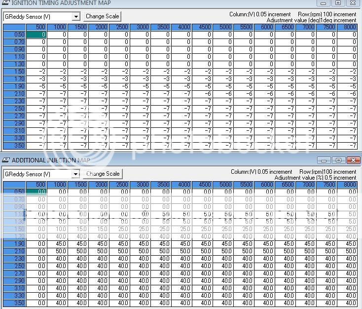

Last weekend Ste performed the O2 mod direct on the Boomslang, bung now in one port, O2 sensor carefully strapped up in engine bay.  Following that we then plugged my laptop in to view the map.  It looked a little (well a lot) like this;
Interestingly, the map has absolutely no airflow adjustment (the 16x16 matrix all zero's), just ignition timing adjust (should that be retard, being negative values?) and additional injection.  On the face of it the map appears quite rudimentary, throwing in 40 - 50% more fuel throughout most of it.  As the blower is on the small side and starts spooling up around 2250, boosting before 3000, I wondered how well suited this map actually is?  Anyway, we then noticed that it was set to use Greddy Sensor input value, presumably from the Profec fitted on the last car.  I don't have the Profec so we concluded the map wasn't doing a great deal.  As an interim a map from a PE install off another car is now loaded.  I'm still limping the car around and when we drove it out with the laptop connected it was only just dipping into the map settings.
All of this just confirmed greater the need to get mapped properly, so this Thursday I'm booked in to Noble for the day.  Just got the 2zz injectors to go in this weekend (adjustment to the e-manage settings to show larger injectors will be made) together with a manual boost controller.

I wm looking to add a diy turbo kit to my roadster.. did you have to use a piggy back ecu ?
Quote from: "dg1989"I wm looking to add a diy turbo kit to my roadster.. did you have to use a piggy back ecu ?
Yes the eManage. You can use a piggyback or a full replacement, lots of info on here have a search.
Yes he has a Greddy e-Manage Blue fitted ... the above are screenshots of the e-Manage maps.

Unless you sack the ECU completely and opt for a standalone mappable unit you'll need to go with a piggyback to get the best out of a turbo application. The Power Enterprise kit (in standard form) gets away without outside mapping by upping fuel pressure. Its crude and it works, but the air/fuel trace looks like a mountain range.  s:? :? s:?  Not ideal - I think all member's PE installs are coupled with EManage Blue or Ultimate piggys. They perform far better on power delivery.
