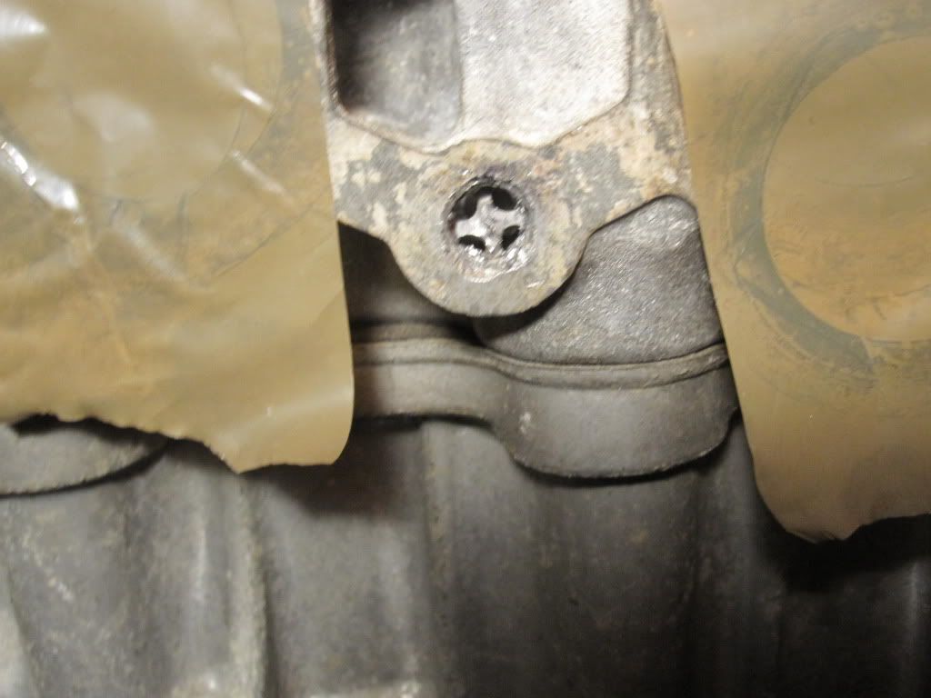

Hi Guys,
Managed to work from home this afternoon and have had a crack at this with the punch.
The ends of the tap were very brittle but it wouldnt turn, however only about 7mm left inside.
Any ideas of a tool to twist this, or shall i continue with the punch and hope the rest is as brittle?
Andy
Looks a mess to me!  Take it to an engineering shop and get the job done right.  Helicoils can be a bugger to get right without breaking taps as well (did you use a plug tap?) I did a Landrover once and that was a swine with a cast iron head and City&Guilds Mechanical Engineering qualification.

Cap
Nice Photo..  Lets me see what you have..   Looks like your 'Run of the Mill' broken tap..  The 'Good Thing' is, you can get to it..  Sometimes you can't..    Good thing is you can take your Time..  that helps..
I have used a Pair of 'Long Nose' needle nose Pliers..   See if you can find a pair.. and use them as a Tap Extractor.. I have gotten A few taps out by Lubricating the Threads with oil, and wiggling the Tap back and forth ( Sometimes it might take a While ) and work the 'Chuncks' of the Aluminum threads out from the Sides of the Tap..  Then  you might be able to screw the tap out..
Some persistence and Use of the Hammer and Punch should reduce the Tap to removable Pieces..   You are Probably going to have to use a 'Full Body Insert' to replace the threads with..  as the hole is going to be too big for the Heli-Coil..  I don't like Heli-Coils any way..  they are too easy to Cross thread bolts into, as the 'Start is Wrong'..  and Sometimes in High heat Situations, the Coil will come out with the Bolt..

Hi again tinky1 please refer to my earlier post it describes exactly the tool you need to try and use, its none of my business but if you chose to ignore advice that is good its up to you. I dont know why I bother!!!!
norman
tinky1
Norman, thanks i do appreciate your help and have been spending my afternoon trying to source the tool your link mentions..
Thanks again when i get this tool i am sure it will get it out   s:D :D s:D

Update - Got the B@@@@@D tap out finally, first set of extractors were 8mm and snapped like dry spaghetti, got the next size up and worked like a dream within a couple of mins.
Got the Helicoil in and the bolt has a nice and tight fit and no blowing or leaks from the manifold.
