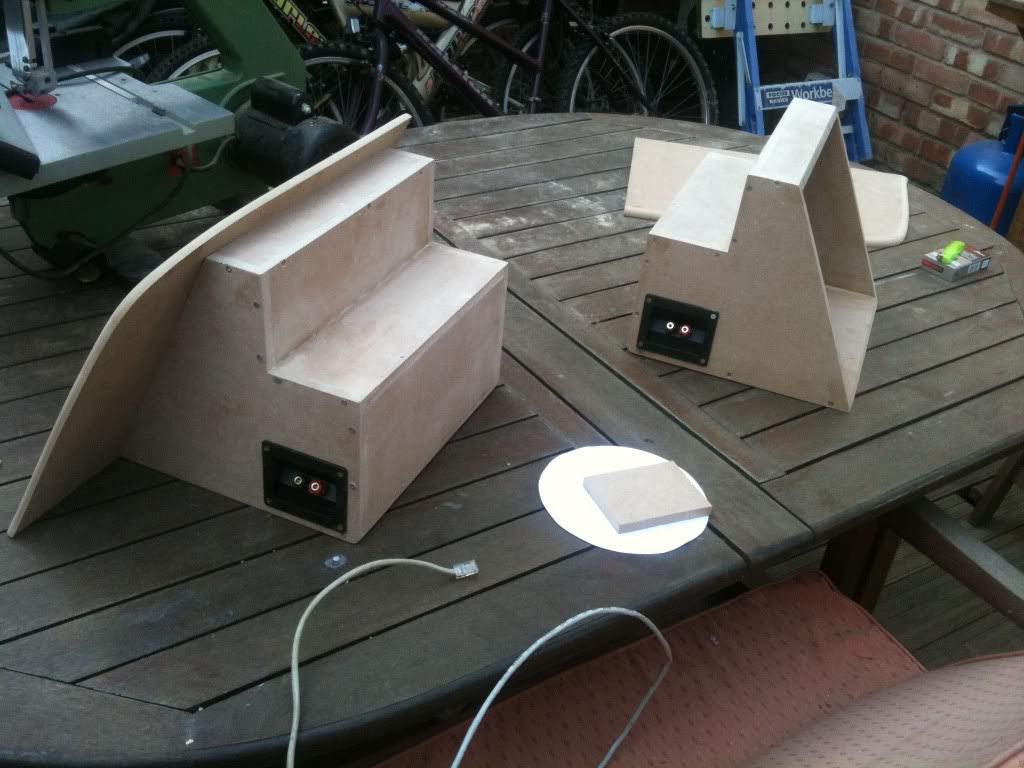

Update;
So been "beavering" away, a picture speaks a thousand words as they say;
Boxes fit like a glove, took the car for a spin, no rattles etc so seems like its in nice n tight. Roof goes up/down. Aye bit more weight in the car but i never thrash about in it anyways really, enjoy posing too much im afraid to say.
Once the subs are here i can carpet, install wadding, fit the subs, wire to the amp.
Got some magical finishing touches planned for the centre console.

I have made a note of the dimensions of the boxes. The fronts are just a basic cut out of the front doors... although ive put a "secret/hidden" compartment into mine on cupboard hinges  s;) ;) s;)  Will show a select few my James Bond box @ Ding Day... and pop up a pic when i have taken one...
So anyways, after a lot of messing around;
There they are in and secure. Almost drilled through the metal behind the passenger seat but found an old post of Aaron's saying that the fuel tank/line was behind it... so stopped immediately... got some uber strong dual lock velcro on the way so will use that! Thanks Aaron!
I've ended up removing the inner bin plastics which has highlighted how much road noise they keep OUT. As a result ill be buying some really thick insulation meant for lofts (looks like a big block of sponge cake) and will cut to the size of the area beneath the boxes, channeling out for the eletronicy stuff down there. This will improve road noise when the subs aren't thumping.
I'm very happy with the look of the unit, and due to not having hooked up the amp yet, cant comment on the sound.
As happy as i am with the look, and i dare say the sound... i cant help but think that its taken something away from the Roadster... don't get me wrong, it looks awesome and will sound great im sure... just at the moment it feels like ive added something that shouldn't be added and takes something away  from the "spirit" of the car, rather than adds... not sure if that makes sense or if im just being a hippy... just feel like the vibes been tampered with...
That may all change once its all working as opposed to a pretty paper weight. On the topic of weight, the car feels no different in speed or handling, the wood didnt weigh too much, will weigh it when i take it out next, but the subs weigh a fair ammount, more than i thought they would.
Will get some better pics and update when the insulation is in and the amps hooked up...
