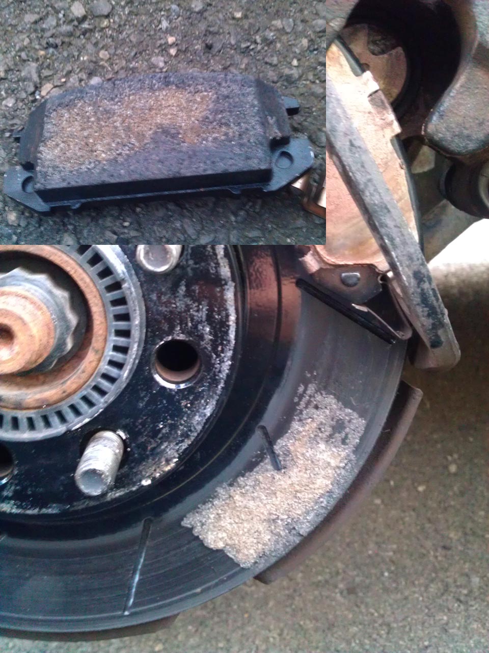

So once I had them fitted I took them out for a quick spin. I put the handbrake on then when I went out in the morning the rears were stuck on hard and the car wouldn't move (oh great!), obviously the black coating had heated up then stuck when it cooled overnight. I tried rocking the car, and all sorted but it wouldn't budge. In the end I had to take everything off again and lever the pad off with a screwdriver which obviously left most of it behind!  s:( :( s:(  :
It took me ages to get all the pad off the discs and refit them. Luckily it's the rear pads otherwise I would've had to buy some new pads straight away but still very annoying!

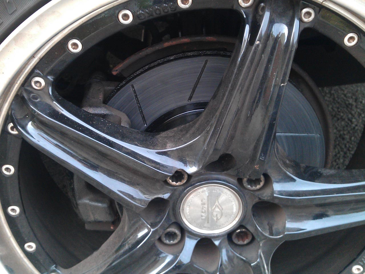

After a few miles driving they were then like this:
Haven't taken any pictures since but they are now pretty much in good shape after about 50 miles or so of driving, only done small journeys so a bit of advice if anyone else buys these is to leave it in gear with the handbrake off when you stop until the black has worn you see pure metal.
