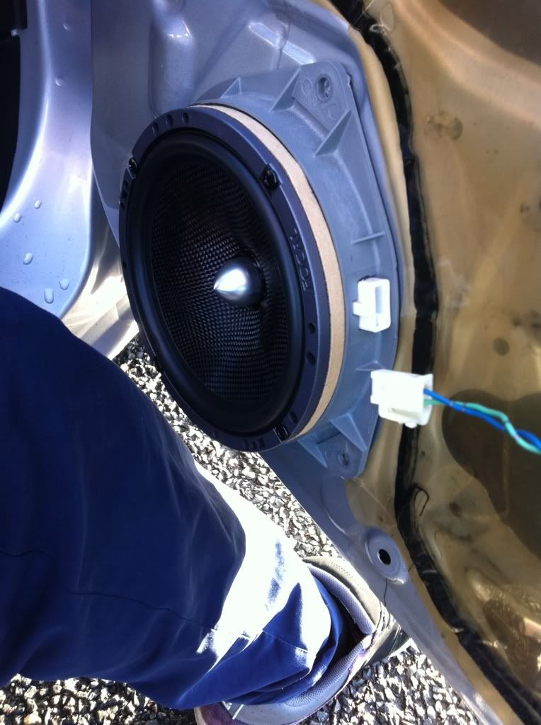

Just the focals at the moment , curious as to why it's doing it?
JoniiBoii
this is the photo with the issue i had just for anyone doing this, take the wooden / cardboard ring off ...
Chris H
#27
plus I'm gunna use flashing tape on the door cards next  s:) :) s:) [/quote]
Dont just use flashing tape on the door cards,do all of the door skin
too,vast improvement.......  s:) :) s:)
JoniiBoii
#28
Shall I rip the yellow cover off ? The one in the image?
Chris H
#29
Peel it off carefully leaving behind the sticky stuff,use flashing tape
to completely cover door skin within this area,then press the polythene
back onto the sticky,hey presto.......did mine back in the summer
after reading Stargazer's speaker upgrade....you cant use to much
of the flashing tape,i covered door skin and door card,big difference.........  s:bounce: :bounce: s:bounce:
