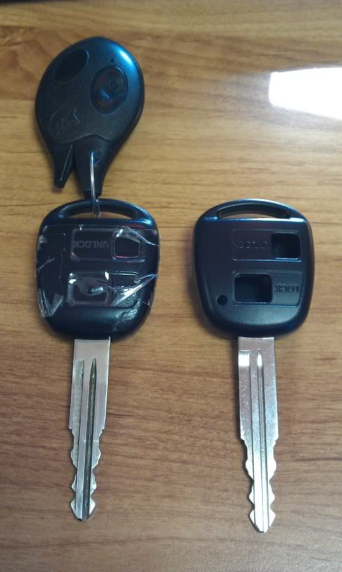

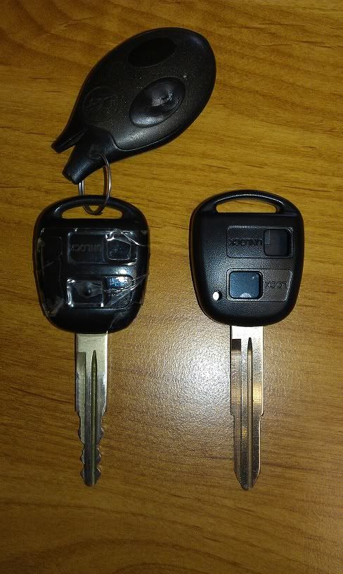

My ignition key fell apart the other day - the plastics broke around the area that secures the base of the key blade - not uncommon with Mr T keys apparently!
After some research I found the correct replacement blank on E-Bay - http://cgi.ebay.co.uk/ws/eBayISAPI.dll?ViewItem&item=180689379012 for £4.95 and had it cut at my local locksmiths £3.50.
All I had to do was to remove the electronics unit (complete with buttons) from the broken key and locate in the new blank - dead easy, it's completely transferable without any difficulty - and for £8.45 I have a new key!- Compare that with Mr T's pricing.........
Key supplier says that unfortunately the MR2 key blank does not yet come in a "folding" format but suggests checking again in a couple of months, which  will do because such a solution will alleviate much of the aggravation that comes with a full length rigid key.
