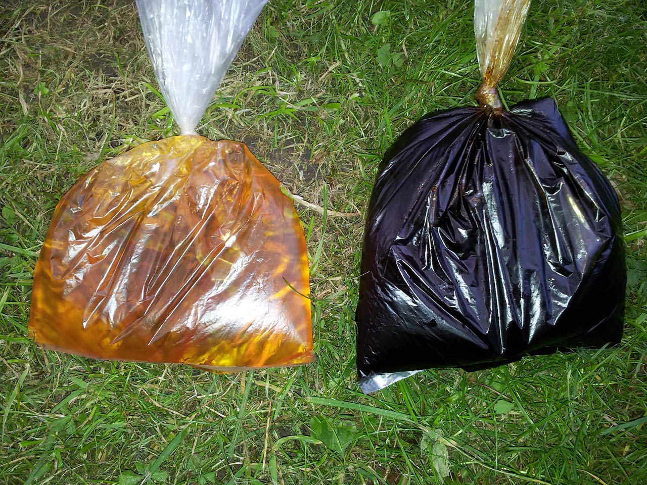

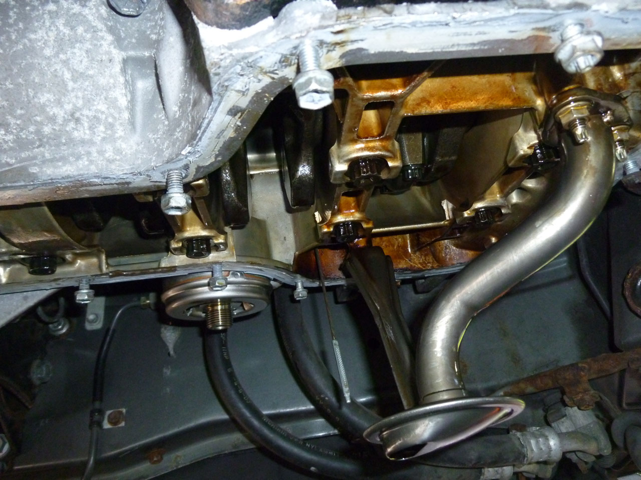

Well just before I went away I got this done as I've got a 200 mile trip tomorrow.
So had posted this on the other thread but here is the oil that came out after I put the engine flush through the system on oil that has done ~500 miles!
So I flushed the oil out, removed the filter and left the oil to drain overnight. I then removed the sump the next day to check the bottom end,
not the cleanest of engines with quite a lot of build up but I hate to think what it was like before the engine flush went through. I tried to clean off as much as I could, it wasn't too difficult so I think another flush next time the oil's changes should get the rest off. I thoroughly cleaned out the sump and have put in the new OCV filter (wasn't quite so tricky this time) and carb cleaned the OCV itself again.
All back together, went on a 10 mile drive, not really sure whether it's more responsive, quieter or anything but no light back on yet. I'll feedback next weekend after 500 odd miles but fingers crossed this time.
N.B. I don't think there's any way that you can fit the new 'allen key style' OCV filter bolt to the MR2, It's a pretty big Allen key and I couldn't get it in even without the bolt there I'd say it's front fitted engine only... so I reused the original bolt and the new filter/gasket.
