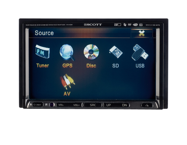

Fitted my new head unit at the weekend, thought I'd post about it here, in case anyone's interested.
My car came with the Sony unit, that seems to have been fitted from new in some cars, and not in others? Double DIN thing with a tape deck on it? Anyway, the CD player in mine was gubbed, so it had to go. Had been looking about for a while, and stumbled across one of these, brand new in it's box, going cheap:
I'd never heard of "Scott" before, but the thing looked the part, seemed to have all the functions I was after, and was cheap enough, that if it was crap, I'd punt it on, take the hit, and buy something else.

So, put the trim back together, and job done! The thing takes a 32gig SD card full of music or videos, has a seperate SD slot for the GPS maps, which makes them easy to update, I can just take the card out, stick it in the laptop and DL the latest updates, it plays DVDs, CDs,MP3's, everything basically, apart from bluray.

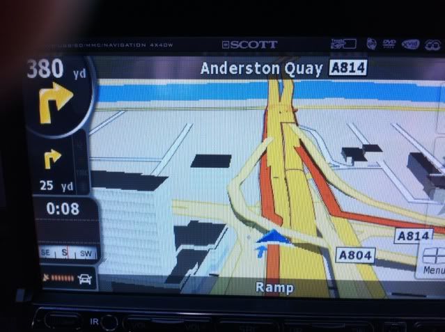

The GPS/sat-nav is actually very good. The display is excellent, and it gives you plenty of information; speed, heading, what's coming up next, and what's coming up after that too, meaning you can plan ahead, make sure you're in the correct lane, etc.
