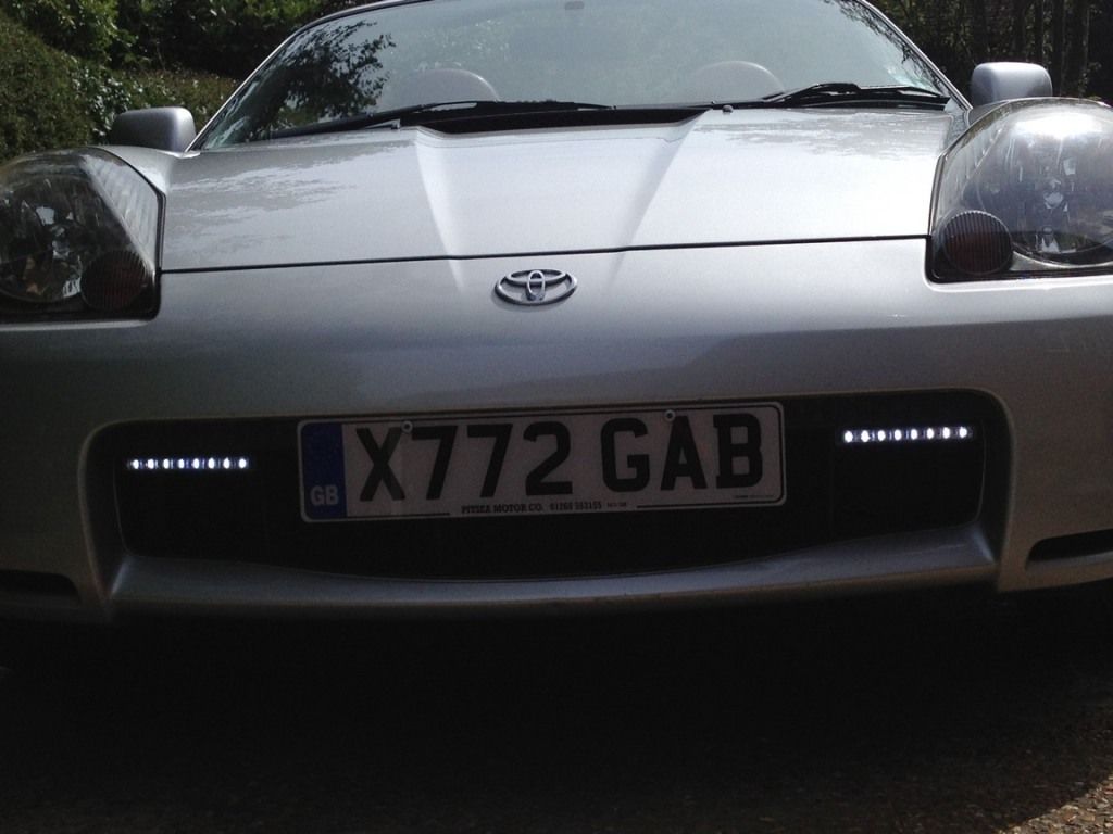

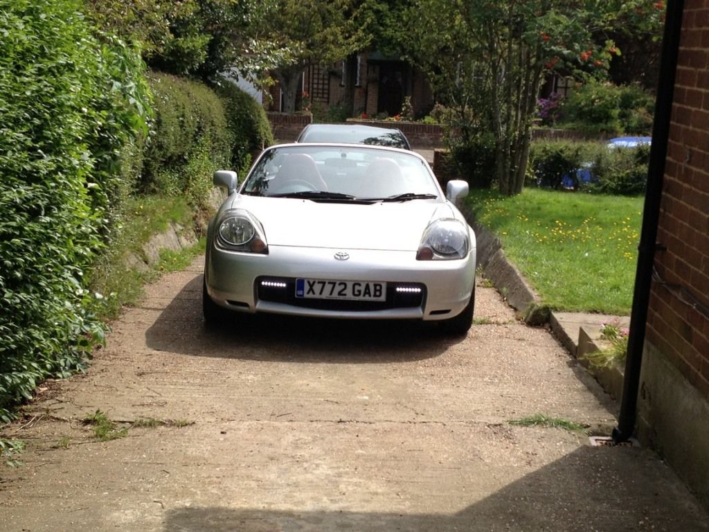

Hi  well decided to go ahead and fit drls, went to -alfords and got Ring 8 x LED Daytime Running Lights, pack included relay/wiring/brackets/screws etc, and using wbarrwebster guide to were cables connect to it was easy to do, decided to fit in grille under black plastic at top. Pleased with result does not look tacky, drls are very bright, photos do not do them justice.

Im impressed,
they look really good to me!
well done on the fitting!

That looks good - I might be tempted to do this myself.  Where did you fit the live cable to?  From what I've read you need to feed this through to the battery in the Ring Instructions.  Do you have a link to the wbarrwesbster guide?

Hi   link to wbarrwesbster guide   l viewtopic.php?f=31&t=32604&p=398866&hilit= l   live wire goes ( to the top middle wire (blue with white flecks ) on the Wiper motor).

Kudos on this install mate looks clean. Looking at your pictures makes me wonder what they would look like in the corner most vents. Photoshoppery?   s:) :) s:)

Hi   these links show the drls fitted in the corner vents ( l viewtopic.php?f=8&t=34115&p=410268#p410268 l ) and ( l viewtopic.php?f=31&t=32604&p=398866&hilit= l ).

looks really good, almost like they are meant to be there, definitely not tacky at all - unlike the rope light look on some Audis.
A very worthwhile mod on a silver 2 IMO
