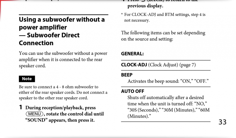

Markb
The diagram with a 2 speaker set up shows one rear speaker wire going to a sub...the other speaker wire seems to be to an earth point......theres settings on the head unit too activate it as a sub.

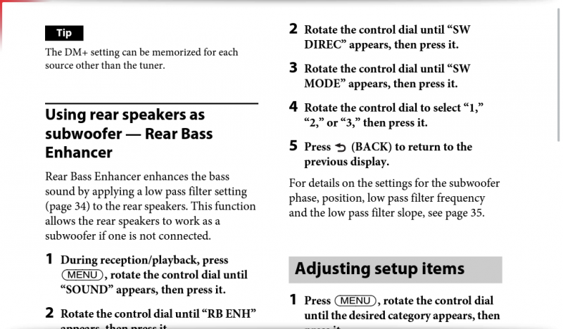

Markb
I know it has the 2 sets of amp rca's and 1 set for a sub......but it does say 1  rear speaker can be used for a sub with no amp....direct sub they call it.....it also can enhance the rear speakers if fitted to sound like subs.

It sounds like it'll work but I wonder how good it'll sound in the grand scheme of things. Although headunits often state things like '50W' per channel, the reality is that the amp hardware that you can fit in there isn't up to providing decent clean power (even if they could they'd overheat). When I had my old ICE setup in my Mini my old Helix amp was stated to be 4x50W but it was night and day difference in practice to my 50W Pioneer head unit output.
My presumption is it this setting effectively bridges the rear channels to give it a power boost to a single source. If you've got a sub handy it might be worth a test but, in my opinion, I wouldn't be laying out money to buy a sub specifically for this sort of setup.
