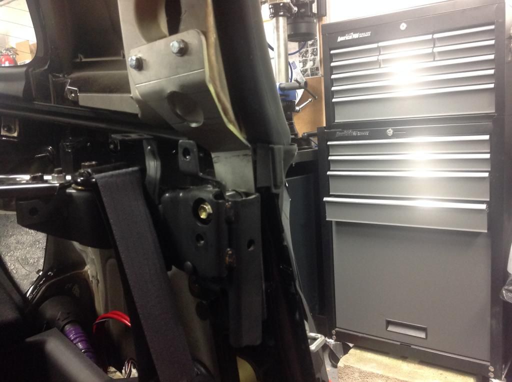

Dead straightforward;
Unbolt cross brace
Remove the existing hardtop clamps (note torx fittings are loctite'd and very stiff)
Plastic trims on hardtop then just clip off
Remove the 3 M8 bolts that attach the seatbelt top bracket to the body
Refit the seatbelt top bracket with rogue top mount sandwiched behind
Surprisingly there is still enough flex to refix cross brace without modifying holes
Although the existing bolts are OK I am going to replace the two front ones with new bolts +5mm in length to make up for the thickness of the bracket.
Does this help?
I've also fitted the front brackets which look quite neat
2001 MR2 Roadster - Cusco front strut brace, Chico Racing shift bushes, soft top delete, 2ZZ-GE, Eliseparts sump, 6 speed box, 4.529 final drive, LSD, custom induction, Zorstec 4-1 manifold, 100cel cat, P&P full cage, RRS 6 points, Cobra Imolas, BC Coilovers (5/7) BattleVersion rear arms, polybushed front arms, poly windows, gutted doors and dash.

That is a massive help thank you.
I've been thinking in my mind that would work but I wasn't sure if it would or not! I wasn't sure about doing the front ones because of loosing all the trim, unless I just trim it around the brackets.

Did you need to buy new bolts to mount the bracket it the hard top ? To replace the black torx ones.
If so, are they m8 fine thread?

Yes those in photo are temp, I've ordered M6 x 25 high tensile flanged button head socket screws (standard thread pitch)
Front brackets you just need to trim the corner of the top windscreen trim so the bracket will sit flat on the frame. I'm just waiting for the new bolts (again got flanged button screws for safety) should be here tomorrow, then I'll post a photo for you.

Quote from: "TiM3"Yes those in photo are temp, I've ordered M6 x 25 high tensile flanged button head socket screws (standard thread pitch)
That would be brilliant, I will need to order some and get them by next weekend as I'm going to Cadwell park. Did you order them locally or from ebay?
I'm surprised they aren't fine pitch thread
TiM3
#273
I got the screws off Ebay, seller is called massiveattack007.
Only seems to be M10 bolts and above that use fine thread pitch on the Roadster from what I've found. I assume because m6 and m8 standard is fairly fine anyway to be honest.
