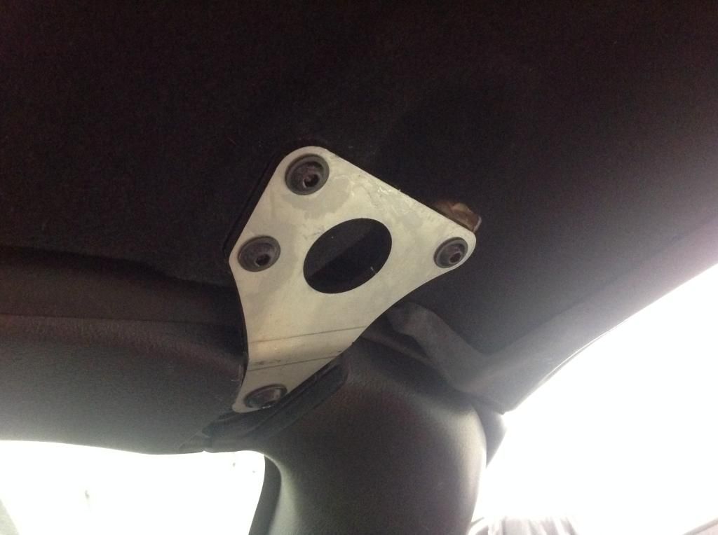

Screws arrived and fit fine;
M6 x 25 bracket to hardtop
M8 x 16 bracket to windscreen frame
Like I said also have to trim the corner off the plastic windscreen trim (see photo)

Thank you, I will order some now.
10off and 2off respectively I assume?
TiM3
#277
Spot on
Very glad I could help!
