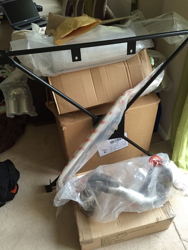

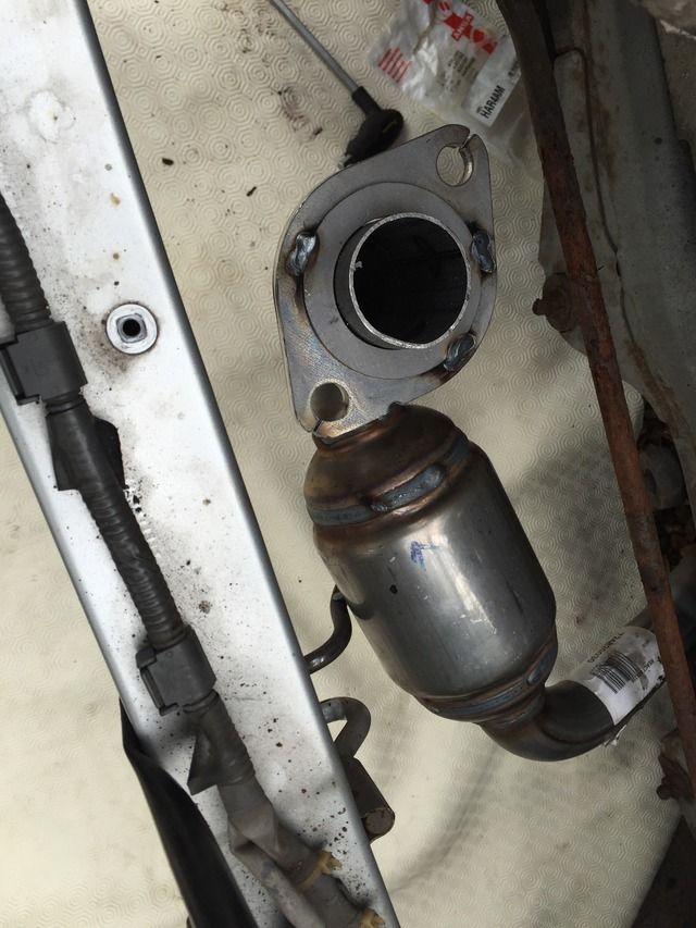

So a few little new parts going on
New cat as the old one was toast
New cobra quad
I was going to do just the "o" ring but bought a new unit
I will stick some better pics up soon

#269
I will update

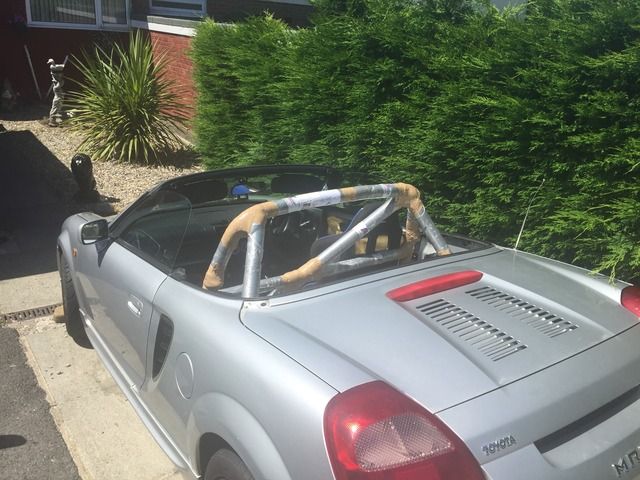

Test fitted cage today
Will try and fit tomorrow
New cat on
New exhaust on
New denso car sensor on
New harness here
Making centre console as we speak
New rear caliper here
Ordered a new helmet too
Money is leaking like I've got sterling diarrhoea
Mitsuko the mr2

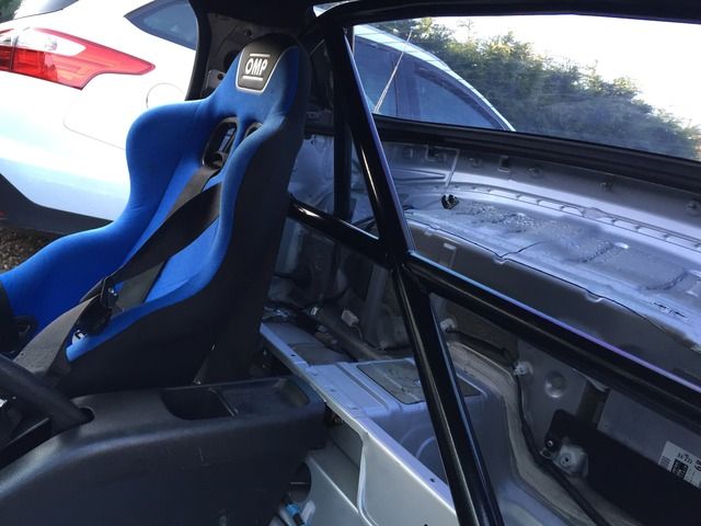

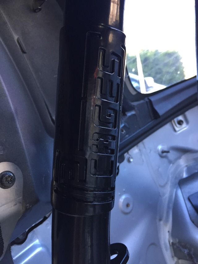

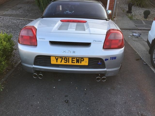

So with work being so busy it's been hard to find the time to get the car to where I want but here's some progress now having the ppcage fitted, new Trs 4 point harness and the new exhaust fitted
So dropped it in when it came just to have a look
Then over a few days here and there got it in
Sorry I didn't take many pictures of the stages
Very pleased with the cage and would recommend
Set me back more than I thought but excellent
And now a finished bum shot with new quad cobra, cat pipe and sensor plus gaskets or as I call it £700 of pain
Mitsuko the mr2

That roll cage looks the part very smart
Excelsior
#272
Nice ! Did you weld the feet. In?
MrStev3
#273
My father did the welding  :-) :-) :-)
I'm not skilled in such things
The plates didn't quite line up with the feet so adjusting had to be done but after all the test fitting and marking my father fired up the welder and welded those bad boys in
Sprayed some paint over to stop the weld rusting , I know its black and the car is silver but nobody will see it
Mitsuko the mr2
