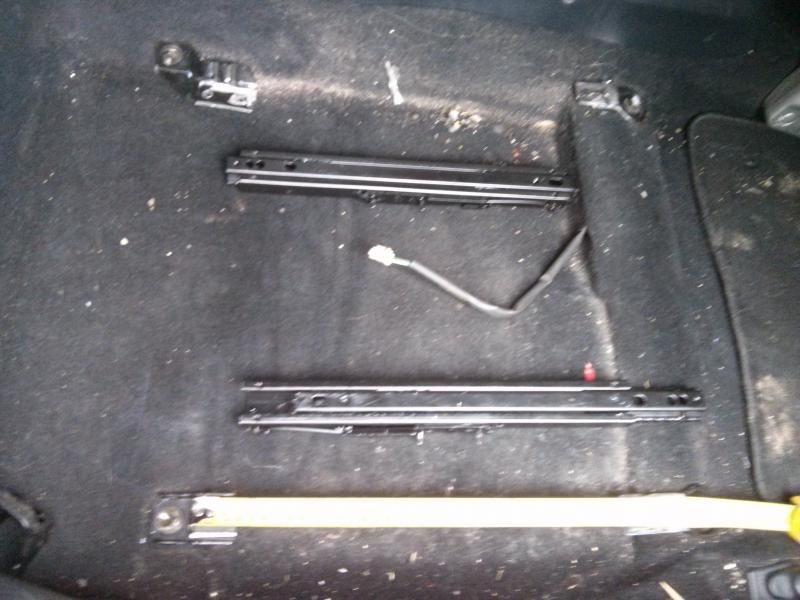

Removed the Drives seat and salvaged the feet from the sub frame to make a new one for the bucket seat shouldn't be to bad, the floor is nice a flat just need to source some steel strips.
